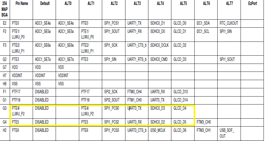

I'm using MQX 4.1, CW10.6, K70 processor.  I'm trying to get the MQX Serial-device driver working on UART3.  I've enabled BSPCFG_ENABLE_TTYD, and everything seems to be initializing correctly as _io_fopen() get a valid file pointer; However, I am never seeing any activity on the serial transmit pin when I do an _io_fwrite().  I suspect a pin configuration problem.  I'm not sure how select the required pins and cannot find any clues in the MQX driver docs.  I'm using PTE4/5 for the tx/rx lines to my RS-232 transceiver.  Any help would be much appreciated.

danielchen
Hi Louie:
Please check my modifications based on BSP_twrk70, I use PTE4/5 as the rx/tx pin according to your requirement

Which board you are using, TWR-K70 board or your custom board?  Could you please dump your  Port E 4/5 configuration (register )value?  The below picture is for Port E 16 (debug console)
According to K70 reference manual, MUX value for PTE4 should be 0x3
