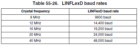

I am using the EVB board, so the external xtal is 80 Mhz, which means I would need 96,000 baud.
I was able to just type in the baud rate on Tera Term VT so hopefully that works.
I tried sending a file or just sending the password and hope for some echo, but I don't see anything and I am wondering what, if anything, I am doing wrong.

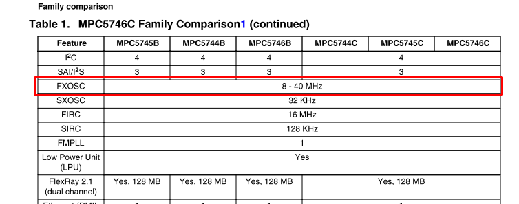

cholland
Contributor V
Peter,
You are correct. I am mistaken. It is indeed 40 MHz.
Other than the xtal, does it look like I am on the right track?

petervlna
are you sure you have 80MHz XTAL?
Peter
