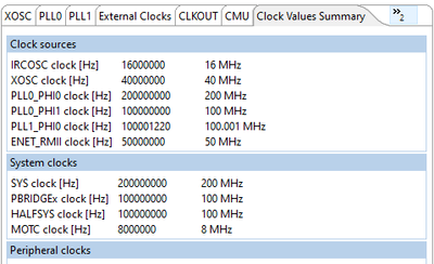

I am working with a library that requires me to provide the crystal oscillator speed as well as the "desired system speed". I already know I am using the default 40MHz crystal, however, I am unsure about what the system speed would be, or where to find that configuration. Any guidance is appreciated!

This ended up being very useful. But I also found a tab in the configuration page for the clock_manager in the SDK, which summarizes all the clock values, so I'll leave this here. Appreciate the help @davidtosenovjan!
