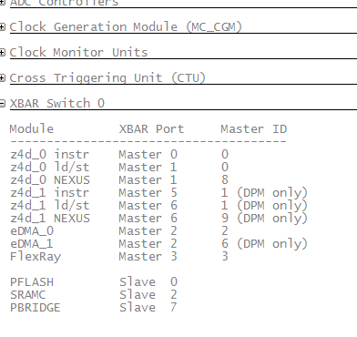

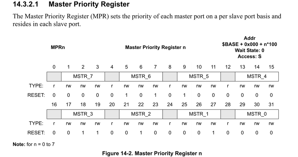

In master priority register you can configure priority of Masters on XBAR:
And debugger screen:

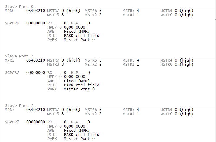

And slave port masters priority:

They will interact exactly as it is configured in your XBAR.
eDMA is master and will have accesses based on configured priority on SRAM slave.
