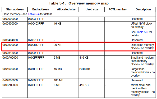

We want to do ECC inject test in EEPROM in MPC5744P, I try to refer the example MPC5744P_1b+2b_FLASH_ECC_error_injection-v0_1-GHS614 as below, and interlock write the address of mid block 0 flash 0x00808000 data to 0x00450000 and 0x00580000, but the ECC error is not occured, Could you help to check my code if is correct, or have other method to do ECC inject test for mid block 0/1 in MPC5744P EEPROM?

   // step2. erase the EEPROM mid block 0 (0x00808000 - 0x0080FFFF)

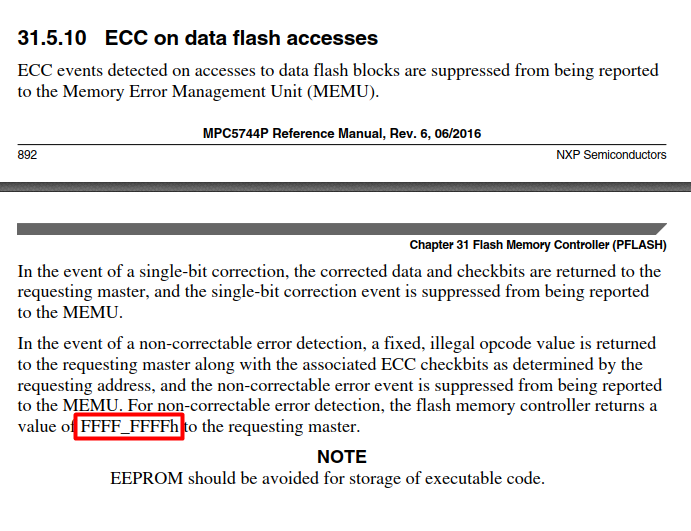

davidtosenovjan
Reading of ECC error in data flash does not respond as bus error nor it is reported to MEMU. Instead it returns 0xFFFF_FFFF.
Check ECC Event Error status flags in C55FMC_MCR register to prove if there is ECC error during read from that area or not.

davidtosenovjan
It is data flash area and on this device expected reaction is returning of 0xFF, it will not invoke machine check handler.
