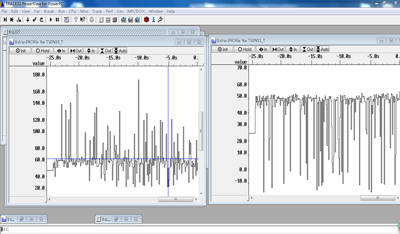

Hi petr,
we download your demo program and run it in our DEMO board. The program seems some problem puzzles me.
When we download the HEX of the example program to 5744pq9  chip, and make it go,  we can see the result of MCU temperature calculate is not stable.
below is the screenshot of Lauterbach debugger.
we can see that the MCU temperature oscillates in -10 and 50 degree. it is obviously not correct.
So , can you help me to find the reason of this phenomenon.
Thank you very much.

I checked it on the MPC5744P EVB and got this result
so hard to say.
What is the full part number you are using?
BR, Petr
Hi Petr,
Thank for your response.
We found that the Vbg0_code and Vbg1_code that acquired by ADC is also not very stable. Can you help me to check your Vbg0_code and Vbg1_code ?
The DEMO program we used is your attachment without changing.
hi Petr,
we have some new discovery.
When we used the CTU to trigger ADC to acquire Vbg0_code or Vbg1_code, the ADC value is not stable.
But when we used register to trigger ADC to acquire Vbg0_code or Vbg1_code, the ADC value seems stabled.
Why?
our CTU trigger ADC period is 100 us, is it too fast?

Hi Liu,
I guess, I had the same problem as you. Here is the answer of the support :"...it is necessary to increase the sampling time for band gap due to slow internal capacitance....".
Since, a note is added in the RM, ADC_CTR0 field descriptions, Bit 24-31 INPSAMP :
   NOTE: The Bandgap voltage sampling time is controlled by CTR0[INPSAMP]. CTR0[INPSAMP] is also
   used for the external channel sample time. When the user software needs to sample the
   Bandgap voltage, it must change the CTR0[INPSAMP] value to allow for a longer time while the
   Bandgap is being sampled, then change its value back to the normal value for sampling external
   channels.
Pat

Hi liu,
A value of 0x50 has been suggested by the design team, which is strongly custom hardware/PCB dependent like noise on voltage reference, etc...  So, be careful.
Pat
