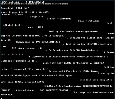

When trying to run the example from the SDK 'evkmimxrt1064_ota_mcuboot_client_enet' I keep getting this failure message 'FAILED to init TLS (ret=-24)'.
Has anyone any suggesting on what the issue is?

Hello, sorry I have the same issue, but I research more information, and it was my PC of the office, I test on my personal computer the connection was established, I use DHCP, I connect the board direct to my modem, start the http server the send the command and the communication was done.

Hello, my apologize for the delayed answerback, we are experiencing a backlog at these days, and I commit a mistake I test only the mcuboot_opensource and that was the image that works for me.
At these days I still having doing testing on this both examples, but I have the next message error.
This behavior is different that you present. Could you let me know the command that you are using to sign the image?
I did the test with the next one.
"imgtool sign --key sign-rsa2048-priv.pem --align 4 --header-size 0x0400 --pad-header --slot-size 0x200000 --max-sectors 800 --version "1.0" app.bin app_binary_SIGNED.bin"

Hello, I test it on my side and the example work as expected, the version of SDK is the 2.16 and the IDE 11.9.1.

Hello.
OK, I was using SDK 2.16 and IDE 11.10.0.
I have tested it on IDE 11.9.1, and I'm still getting the same error.
Are you using DHCP?
Are you running the example in debugging by using 'jump ResetISR' or are you signing the binary image and running it on the RT1064?
