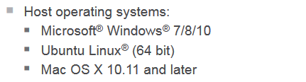

Officially MCUXpresso IDE installer only supports Ubuntu Linux (64bit). but doesn't support fedora.
These are MCUXpresso IDE officially supports systems:
For detail, see this url:
MCUXpresso IDE|NXP
