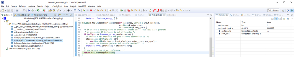

TL;DR - "this" no longer appears in the Variables view when debugging a C++ class.
So, I've pulled down MCUX v11.0.0 and installed it... I've also grabbed SDK v2.6.0 for the RT1050.  I created a brand new workspace, set my templates and code style, set my hotkeys, installed the SDK, created a new C++ application, picked all the middleware, merged in all my previous application code, merged in my preprocessor defines and include directories, and after a bit of fiddling, got my "new" application to build.  It even downloaded and ran the first time, which I'm thankful for.
However, my code got hung up during initialization, hmm.  So I drill in with the debugger:
Now, upon reflection, I understand why this function failed... I haven't yet gone in and re-arranged the heap, stack, and data segments, so they're still pointing to internal SRAM, and I'm pretty sure the heap just ran out of memory, thus yielding a null pointer.
But what concerns me is the Variables view.  I'm in the NxpLpi2c::CreateInstance() method, which means I'm inside the NxpLpi2c class.  When I've debugged with MCUX in the past, there's always been a "this" symbol automatically added to the Variables view when debugging C++ methods.  So... where did it go?  It is invaluable to have access to the current object in the Variables view.  Please tell me this is an easily remedied oversight.  Thanks.

Emphasizing that the problem can be replicated only on v11.0.0 is probably a very important aspect. And we're still looking into the issues reported. However, for everyone experiencing problems with Variables or Expressions views, please try disabling "Live Variables" service when using PEMicro/JLink probes. This can be achieved by going to Window => Preferences => Expand "MCUXpresso IDE" categoy => Select "J-Link Options" or "PEMicro Options => Uncheck "Enable Live Variables service".

The problem with the Live Variables service that was triggering this issue should be resolved with MCUXpresso IDE v11.0.1:

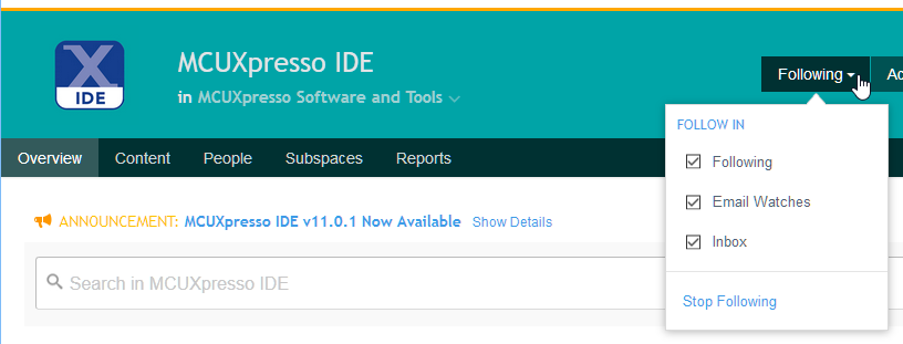

BlackNight
Hi David,
one way is to follow the forum:
I hope this helps,
Erich
PS: Or you might follow my blog where I usually write about new releases (e.g. NXP MCUXpresso IDE 11.0.1 available | MCU on Eclipse), or about all and everything the Embedded end Eclipse world, or even beyond :-).

So the answer is "no", then.  I tried following one of the subforums, and now I'm getting emails for each individual post and comment in the subforum.  So either I turn on the fire hose of notifications for an entire subforum, or nothing.  I'll take nothing, thanks.
Really, would it be that hard for NXP to set up a notification list for its software and tools?  ARM mbed does it.  TI does it.  Renesas Synergy does it.  IAR does it.  Silicon Labs does it.  This is a shortcoming on NXP's part.
EDIT: So it seems that NXP does have a notification mechanism for updates, but it is inconsistent and inadequate.  If I search for emails from "nxp@flexnetoperations.com", I see some Software Notification emails, including one for the 11.0.1 release.  The next previous MCUX email was for 10.2.1, then 10.1.1... I think I see the problem.  Your MCUXpresso IDE software appears in Flexnet under a main heading, say, MCUXpresso IDE 11.0.  If I go and download 11.0.0, and then you release an update in that same version family (e.g. 11.0.1), I get a notification that a minor update was released, because Flexnet sees that I previously downloaded 11.0 and you released an update against it.  But if you then release MCUXpresso IDE 11.1 at some point, I won't get a notification for that, because it's a new software item, i.e. it appears in its own heading.  So this doesn't solve the problem of announcing new IDE software releases, and doesn't address new SDK software releases, either.

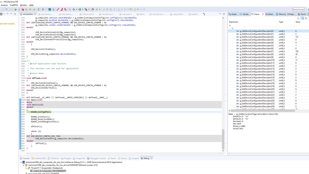

nxp16
Unfortunately, this still happens in MCUxpresso 11.1 using LinkServer debug (which doesn't have the option to turn off Live Variables), on an IMXRT1060 evk board.  Everything in the Expression view is blank until I click on one of the array elements.  No matter what I do the parent names never show up.

lpcxpresso_supp
First of all, your screenshot illustrates a problem with regards to some views. Note the red square icon associated with Global Variables and Heap and Stack views. It's a sign that you're reusing a workspace created with an older version of MCUXpresso. So those view cannot be used in their current state. I recommend switching to a new workspace.
Secondly, please mention the actual expression you added in the Expressions view. I tried to reproduce the problem with the same project but on an IMXRT1064-EVK board. Everything works as expected. Would you please try adding that expression in the Global Variables view and check if you still see the issue?

Unchecking "Enable Live Variables service" returned the functionality of the variables tab on my 11.0 installation.

I will also confirm that disabling Live Variables Service has gotten me past the debugging issue with 11.0

I can confirm that disabling "Live Variables" restores my debug functionality, which means I should be able to use MCUX 11 again.  Sounds like the Live Variables feature needs to go back to the lab; it's not ready for primetime.  My gut impression is that Live Variables was completely bogging down the debugger, to the point where single step commands would simply fail to execute.  I don't know what benefit that feature is supposed to provide, but clearly the feature is broken for many of us.

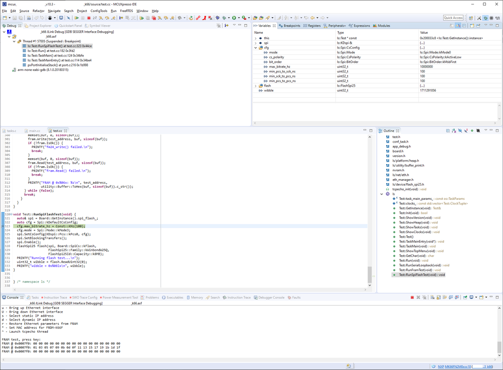

So, further update... on the advice of Harald Adolph and Jay Larson above, I created a new MCUX 10.3.0 workspace, pulled a fresh copy of my project from SVN, managed to get a pre-2.6.0 K66 SDK from my co-worker (fun fact: can't build older SDKs with MCUX), got my project compiled, shift-clicked the blue bug, launched the debugger, set my breakpoint, triggered the test routine, and...
Lookie there... the Variables tab works just fine.  Debugger is relatively snappy and responsive with step into/step over actions.  (The Global Variables tab still takes a very long time to draw if you click on it, and basically freezes the IDE while it does this.  I just middle-click it to close it without even switching to it.)
So, there's my workaround... stop using MCUX 11.0.0 and continue to use 10.3.0 until such time as NXP decides they want to get to the bottom of this.  We'll see.
