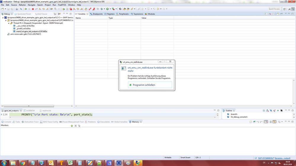

Hi, trying to debug project on LPCXpresso54608 Dev. board (LPC54608J512ET180 MCU from NXP) and cannot see GPIO registers. I want to see the content of all the ports and pins of GPIO, but in the "Registers view" I see only Registers r0 - r12, sp, lr. pc and so on... (see the pictures). Cannot see GPIO here.
I see GPIO only in "Peripherals", but when I try to check this option here I get always "Remote communications error" and then "No registers found for GPIO". Then MCUXpresso IDE stops working and doesn't see target anymore. I need to reconnect dev.board again and restart MCUXpresso.
All other options under "Peripherals" are working - e.g. "ADC", "LCD" and "IOCON".
How can I see the content of GPIO registers in MCUXpresso?

vladimirilyenko
Hi, I have tried it again with the SDK Sample "lpcxpresso54608_driver_examples_gpio_gpio_led_output" and have the same result - errors.
The Version of MCUXpresso IDE I'm trying it with is: MCUXpresso IDE v10.1.1 [Build 606] [2018-01-02]
SDK Version is: 2.3.0
Host OS is: Windows 7 Professional SP1 64-bit.
After trying to look at GPIO in Peripherals View I've made screenshots of error messages.
I attach here these screenshots along with the ZIPed .log file from the .metadata folder from workspace.
Crash message says: "crt_emu_cm_redlink.exe doesn't function anymor - close the program."
Hope it'll help to find the problem.
