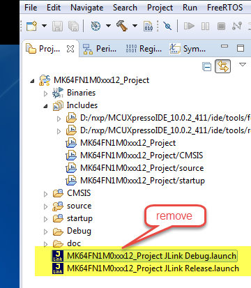

I would like to program and run release code to my target using MCUXpresso, without any debug mode overhead.
My programming interface is a PEMicro Multilink Universal.
I have created a "run" configuration that references the release build of my code.
However, when I click "run", MCUXPresso starts a debug session, and never asks me about what hardware interface I'd like to use (or even what port the target is on).
The debug session doesn't have an interface for termination (right clicking simply gives an option to "re-launch")
I am lost as to how to run my code without starting a debug session.
Any help is appreciated!

I experienced the similar problem as yours when I use MCUXpresso IDE.
if the connection and firmware has no problem, most of times, I can fix the problem by removing all .launch files in the project.
if removing .launch file can not solve the problem, try create a NEW project in a NEW workspace and see how the connection works.
