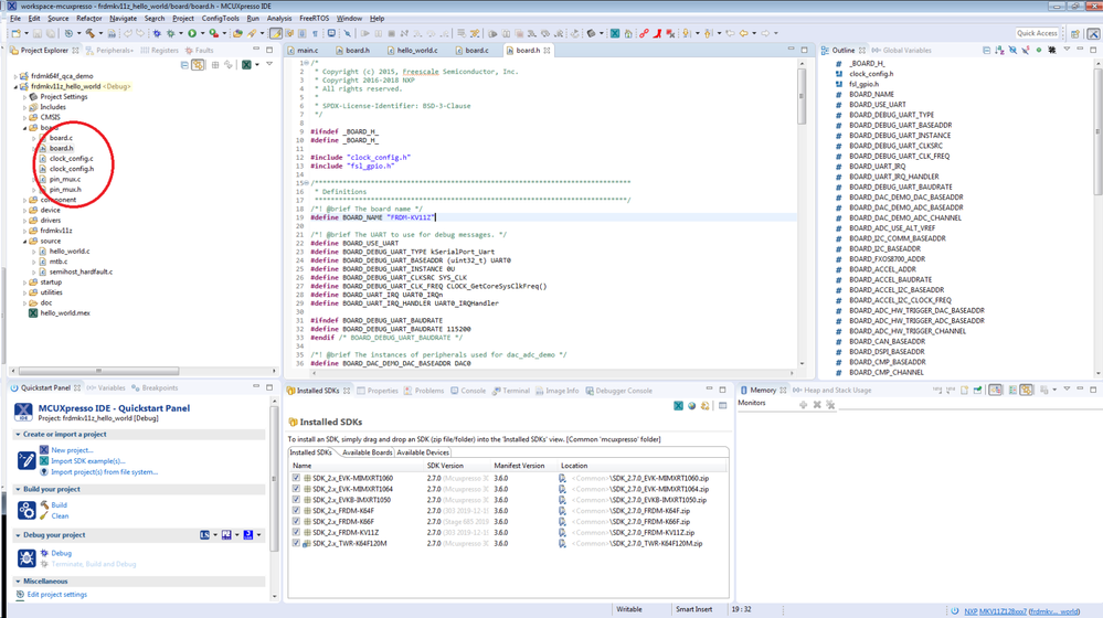

I just got a FRDMKV11z dev kit and am trying it out the MCUXpresso IDE.  I'm wondering why I am looking at the schematic to update the configuration of pin connections in order to drive the right GPIO's etc.  Since the board is already built and connections aren't changing isn't there a configuration file to load that would already have the boards connections defined?  But I don't see one.

The board configuration file is under folder board.
