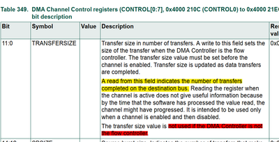

I am trying enabled burst DMA for hsadc.
It work as DMA as flow-control(0x2), but I need peripheral flow-control (0x6) for more efficiently. here will some items not clear. is any one have comment with red color part.
  LPC_GPDMA->CH[DMA_CH].SRCADDR = (uint32_t) &LPC_ADCHS->FIFO_OUTPUT[0];
  LPC_GPDMA->CH[DMA_CH].DESTADDR = (uint32_t) sample);  // should I set to zero
  LPC_GPDMA->CH[DMA_CH].CONTROL = (DMA_TRANSFER_SIZE)  ç  programming guide said peripheral flow control(0x6) will ignore this field,However when set to 0, nothing FIFO data been transferred
  | (0x0 << 12)
  | (0x0 << 15) // dst burst
  | (0x2 << 18) // src傳輸寬度,0x2表示以字的形式傳輸
  | (0x2 << 21) // dst傳輸寬度,0x2表示以字的形式傳輸
  | (0x1 << 24) // src AHB主選擇
  | (0x0 << 25) // dst AHB主選擇
  | (0x0 << 26) // src增量:0,每次傳輸後src位址不遞增
  | (0x1 << 27) // dst增量:1,每次傳輸後的dst位址增量
  | (0x1 << 31); //What is Terminal count interrupt
  LPC_GPDMA->CH[DMA_CH].CONFIG = (0x0 << 0) // channel eabled ç burst mode is set to 0?
  | (HSADC_DMA_READ << 1) // src外設:設置為8-HSADC
  | (0x0 << 6) // dst外設:無設置-記憶體
  | (0x6 << 11) //流控制:外設-記憶體(0x2 working),XXX -  Now test 0x6
  | (0x1 << 14) // IE-中斷錯誤遮罩
  | (0x1 << 15) //  ITC-ç The impact is not clear
  | (0x0 << 16) //lock ç The impact is not clear
  | (0x0 << 18); //進一步忽略src DMA req  ç Confirming.
  LPC_GPDMA->CH[DMA_CH].LLI = LLI_Table;  ç How to make DMA reload LLI automatically

robberpen
Hi @Harry_Zhang
Thanks your reply, I will verifying your comment.
Based from the doc below, TRANSERSIZE not use if the DMA Controller is not the flow controller.
So the DMA how to know the buffer size should be copied in each continuously DMA burst request.
I supposedly the scatter/gatter with LLI mechanism is not work if flow controller is not DMA, Please have comment

Harry_Zhang
Hi @robberpen
Based on the documentation snippet you provided, the TRANSFERSIZE field in the DMA Channel Control register is indeed not used if the DMA Controller is not the flow controller. This implies that when the peripheral or another component is controlling the flow, the TRANSFERSIZE field does not dictate the size of the transfer.
