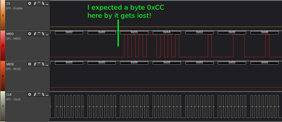

Hello all,
I am observing inconsistent behavior on the SPI bus implemented in the SSP peripheral on LPC1768.
Is there a restriction on keeping the SSP TX FIFO empty while data is being received by the RX FIFO and then start to send?
  • Issue:
    • Data written to the register is sporadically discarded/lost in SPI and not sent by LPC1768 (observed with a logic analyzer).
    • The problem occurs in 15% of cases.
  • Implementation Details:
    • LPC1768 operating as SPI slave (SSP peripheral).
    • Peripheral clock: 100MHz.
    • Bus clock: 1500kHz (SSP0CPSR.CPSDVSR = 0x42, SSP0CR0.src=0x00).
    • Read and write via IRQ Handler.
    • Data is consumed using extremely stable circular buffer.
    • No RX overrun events observed.
  • Precondition:
    • The master device is constantly sending data to the bus.
    • LPC1768 firmware does not write to the DATA register (SSP0DR) when there is no data to send.
    • Status register (SSP0SR) indicates "TX FIFO empty" (SSP0SR.TFE == 0x01).
  • Scenario where the problem occurs:
    • When there is data to be sent, the SSP TX interrupt is enabled (SSP0IMSC.TXIM = 0x01) and the handler writes the data sequentially to SSP0DR while there is space in the TX FIFO (SSP0SR.TNF == 0x01).
  • How the problem manifests:
    • Using a logic analyzer, it is observed that, in 15% of cases, the first byte is not sent by the bus to the master. It gets lost.
  • When the problem occurs, these are the register values before and after writing the first byte to DATA:
    • Before writing the first byte to SSP0DR:
      • a) SSP0MIS: 0x00000008 or 0x0000000C
      • b) SSP0SR: 0x00000003 or 0x00000013 or 0x00000017
    • After writing the first byte to SSP0DR:
      • a) SSP0SR: 0x00000016 or 0x00000017
Best Regards, Wagner Popov

I see that you configure the SSP module of LPC1768 as slave mode, as you know that the SSP has 8 level FIFO for both transmitter and receiver, I suggest you fill the 8 level transmitter FIFO in advance before you enable the SSP.
Pls have a try
Hope it can help you
XiangJun Rong
