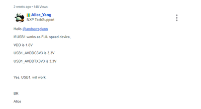

Here's our setup:
VDD is 1.8V
USB1_AVDDC3V3 is 3.3V
USB1_AVDDTX3V3 is 3.3V
From what you are saying, USB1 will work as a High-Speed device, but will fail as a Full-Speed device because VDD is not 3V or higher?
Is this correct?
3,424件の閲覧回数
Hello @andrewsglenn
If USB1 works as Full- speed device,
VDD is 1.8V
Yes, USB1, will work.
Alice
