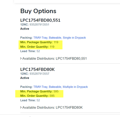

I have found in the pricing book that there is another variant of LPC1754FBD80 called LPC1754FBD80K
could you please advise back what is the difference between the two and if these PNs are a drop-in replacement to each other?

Hi @shai_b
For LPC1754FBD80, we have two PN, LPC1754FBD80,551 and  LPC1754FBD80K
https://www.nxp.com/part/LPC1754FBD80#/
I guess your "LPC1754FBD80" means "LPC1754FBD80,551"?
If so, the only difference between LPC1754FBD80,551 and  LPC1754FBD80K is packaging. see below:
The chip itself is the same. No difference. LPC1754FBD80K is new packaging.
