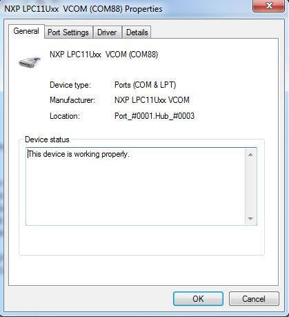

I attached the following files.
- Screen shot of Device Manager
- LPC11U14 VCOM driver file
I'm very sorry, I was telling you the wrong information about the PC I am using.
Here is corrected PC information.
Previously I'm using Windows XP Professional Version 2002 Service Pack 3, Windows XP PC can recognized LPC11U14 VCOM driver and it working correctly.
Currently, I'm using Windows 7 Professional Service Pack 1 (32-bit), Windows 7 PC does not working correctly with attached VCOM driver.
Does the attached VCOM driver work properly with Windows 7?

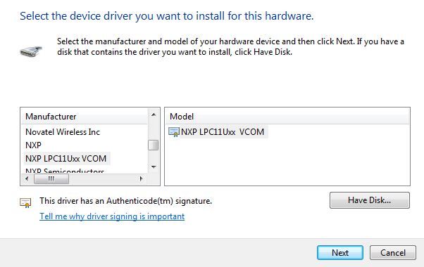

The drivers you are using are not the correct ones. Please install the following drivers.
Once I installed the drivers I ran the example VirtualSerialDevice of the LPCOpen for the LPC11U14 on a PC with Windows 7 32-bit. I updated the virtual COM driver for the one I just installed.
At the end the PC recognized the Virtual com successfully.

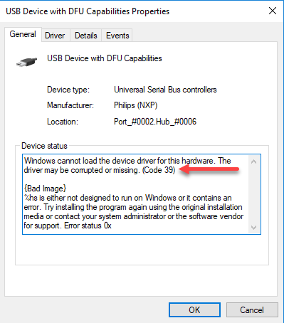

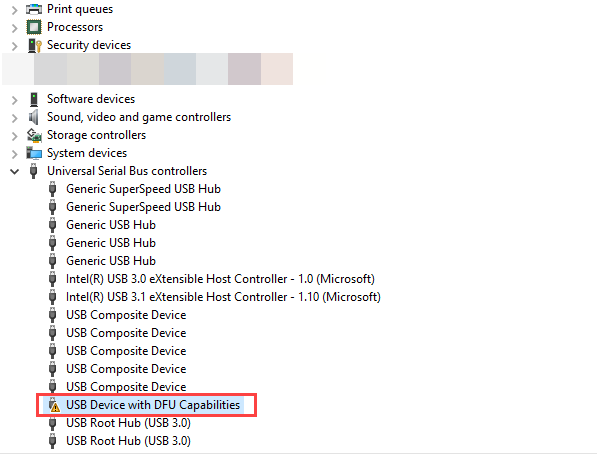

Could you please confirm if the problem you are facing on your Windows 7 PC is that your device is being recognized as shown below.

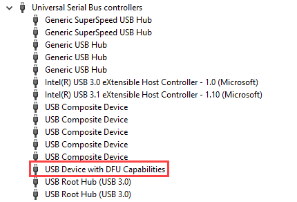

I was able to reproduce this behavior in a PC running Windows 10, but not with Windows 7. After a little research I found out that this problem was due to Windows itself and has nothing to do with the firmware of the board. To fix this on my Windows 10 PC I followed the procedure mentioned in the following link: Windows 10 V1803: HCVI causes driver error code 39 | Born's Tech and Windows World  That fixed the problem as shown below.
After, I just boot the debug probe with the help of MCUXpresso and everything went OK.
For a PC running windows 7 the procedure is different, you can follow the steps mentioned in the following link: How to Delete the UpperFilters and LowerFilters I couldn't test this procedure since in my PC with windows 7 I didn't face any problem, so please let me know the results on your side.

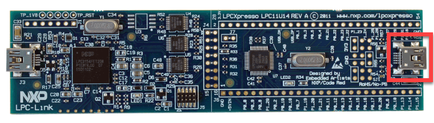

victorjimenez
Hello Takashima,
The drivers attached before are only for the virtual COM of the LPC11U14 within the LPCXpresso LPC11U14 board. These drivers are for the connector J8 of the board.
The firmware.bin of these drivers cannot be use to update the firmware of the LPC-LINK of this board. As you mentioned the LPC-LINK is a LPC3154 and the drivers attached before are for the LPC11U14.
I will investigate the correct way to update the drivers of the LPC-LINK of this board. I will let you know as soon as I have the answer.
