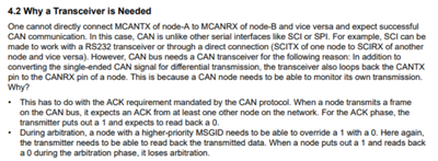

2)There is a description about CAN transceiver:
Alice
39,586 Views
FFOXZ
Hi @Alice_Yang
This description about CAN Transceiver as you send is from a public document?
Would it be possible for you to share this document?
Tks,
CVSta
39,468 Views
Hello @FFOXZ
I think you are going to the wrong way if you still want do not use transceiver.
You can check CAN protocol about detail, and for your final application, two CAN nodes and transceiver  are needed.
Sorry I didn't remember where the description come from.

On the physical CAN bus, there are three connections : GND, CANH and CANL.
At rest, CANH and CANL are at the same voltage level. The actual signal is differential, i.e. the bit value is represented by the voltage difference between CANH and CANL.
This in turn means, there is no direct relation between CANH and CANL on the bus side, and CAN-Tx and CAN-Rx on the MCU side. The CAN bus does not allow synchronous transmissions SPI or RS232, only one node can transmit at any time.
Thus I think every node (like the CAN peripheral unit on the LPC54xxx) is blanking out Rx internally while it is transmitting (Tx).
Which means, you usually cannot bridge Tx and Rx, and expect it to work.
That dawned on my only yesterday. Since I have quite a lot actual CAN devices at my disposal here, I hardly ever played with internal loopback modes.
The CAN peripheral unit of the LPC54xxx obviously contains provisions to  "shortcut" the physical pins (Tx and Rx), which allows for a direct reception of "transmitted" messages". This is mentzioned internal loopback mode.
I think you will need a second CAN node.
This could be a CAN adapter for the PC (USB-CAN), or the second CAN peripheral of the MCU. The LPC54628 has two CAN units.
USB-CAN adapters have only CAN bus level outputs, so you would need transceivers for your MCU side.
In case you use CAN0 and CAN1 of the MCU, you could make direct TTL level connections (CAN0-Tx with CAN1-Rx and vice versa).
