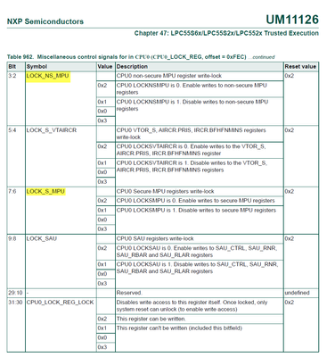

I want to know if NXP MCUs with TrustZone-M support locking the Non-secure MPU (i.e., MPU_NS) configurations by setting certain bits? This feature is supported by several ST MCUs such as STM32L552ZE.

xiangjun_rong
hi,
I suppose that you asked the LPC55S69, it is based on Cortex-M33 and has trust-zone module.
yes, there is register to lock/unlcok writing the MPU registers.
Pls refer to section 47.4.75 Miscellaneous control signals for in Primary CPU0 in the UM11126.pdf
Hope it can help you

Thanks for your reply. That's exactly what I want to know.
