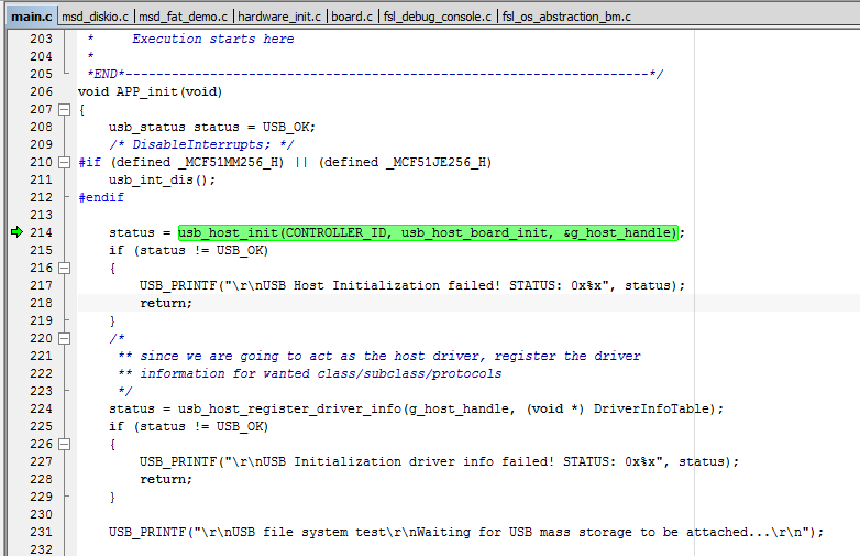

Hi everyone,
I am using the demo app host_msd_fatfs_frdmk64f to write my USB driver.  After much headaches
troubleshooting, etc... I got the project to do a usb_host_init and usb_host_register_driver_info.
I also have it running, but unfortunately when I insert a USB stick the code seems not to detect it.
I keep getting case USB_DEVICE_IDLE and the g_mass_device[i].state_change = 0.  I believe that
it could be an issue with the interrupt of the USB.  I would like to know where does the demo software
setup the interrupt settings for the USB (USBx_INTEN).

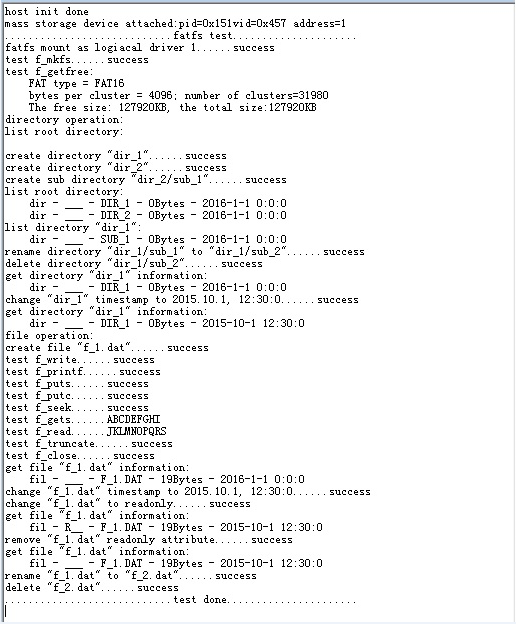

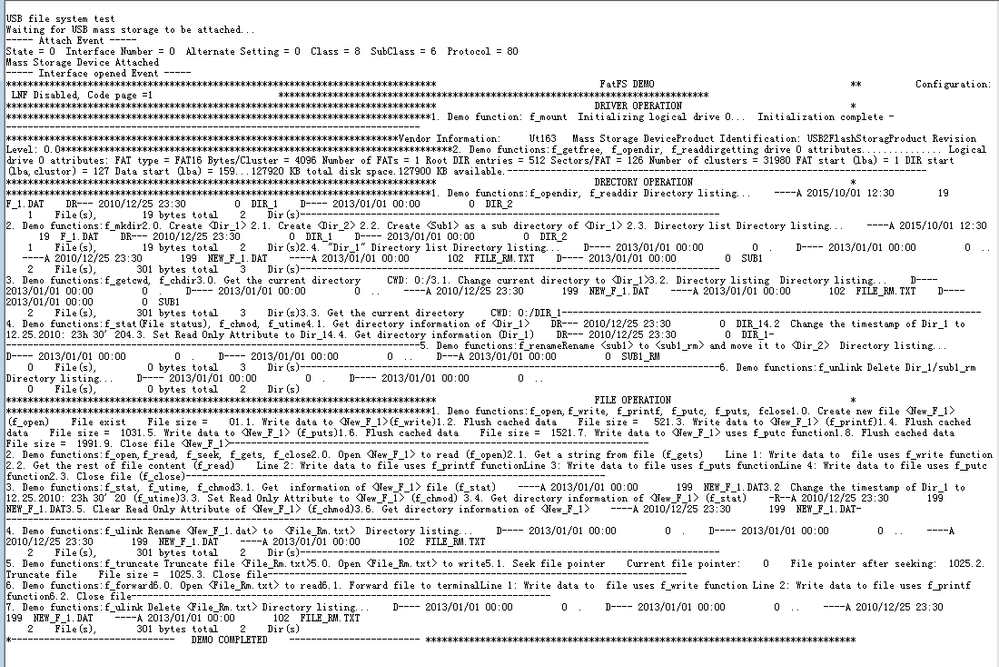

I did a quick check with this demo with Frdm-K64 board, the console output is like this. Have you modified the source code?

I tried this with J-link, I can see the console output.

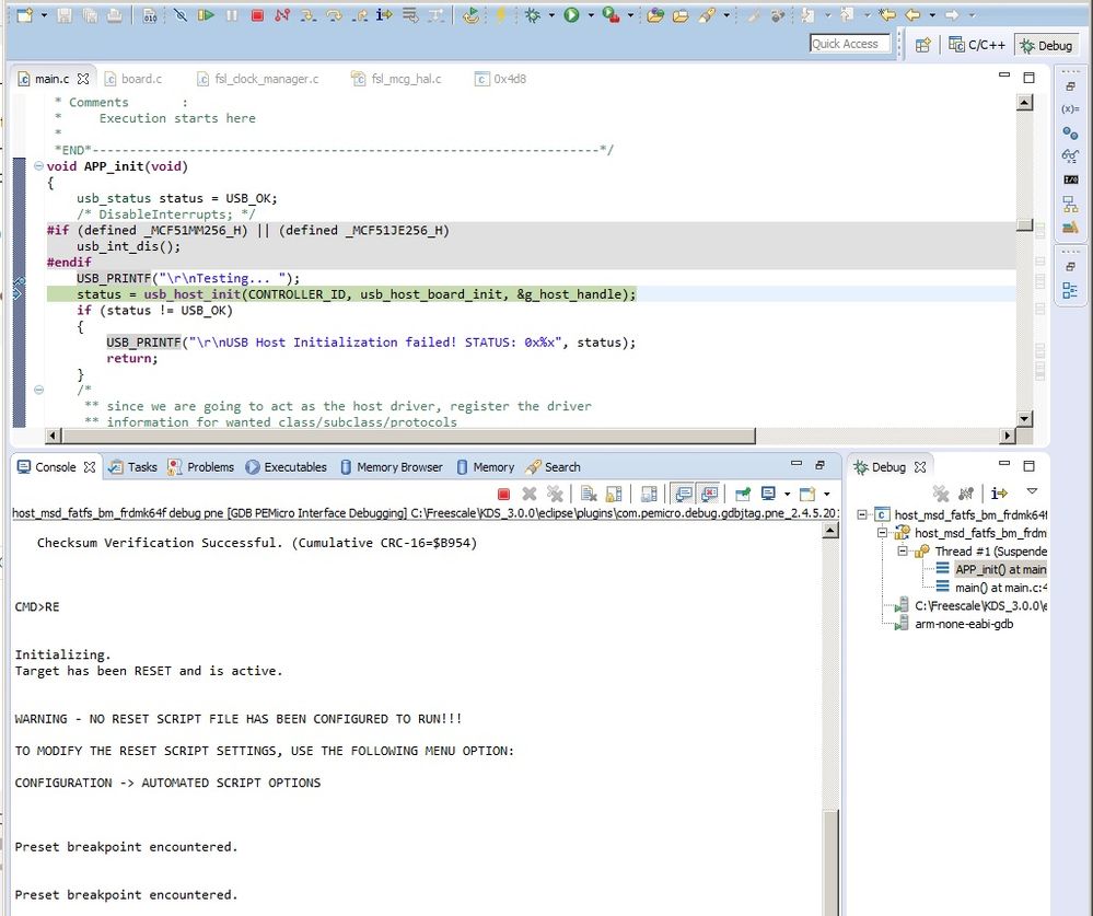

I would suggest you print something before usb_host_init, since you are suspecting the terminal communication problem.
add the below line before usb_host_init, and while debugging you will see this on console if communication is OK
USB_PRINTF("\r\nTesting    ");
If communication is OK, then we continue to check the USB detecting issue.

I included the following line to the demo project as you suggested:

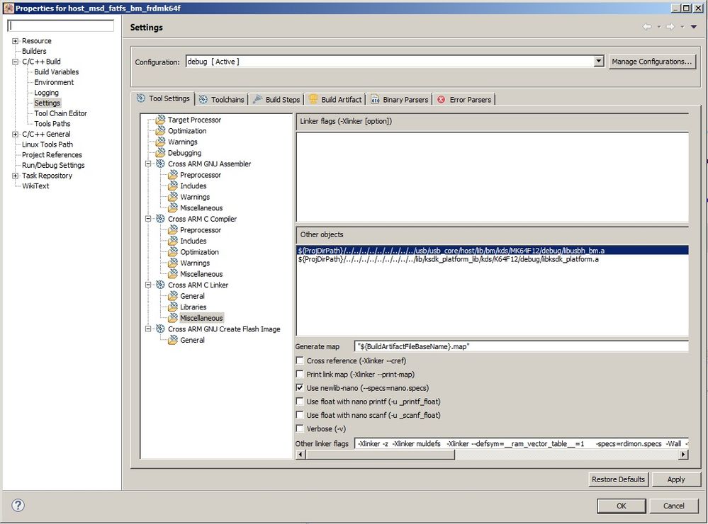

That line does not appear on the Console as you can see from above.  Here is my configuration
Startup settings:
As you can see Semihosting Settings is Enabled and GCB client is checked.  I am going to search
today to see if I am missing something to be able to write to the console.
Note: I am also using the same as you
         KSDK_1.3.0\examples\frdmk64f\demo_apps\usb\host\msd\msd_fatfs\bm\
Let me know if you can see anything from my to screen shots or if you need more information?

I am trying to see why the demo project is not writing to the console.  I am following the steps here:
Semihosting for Kinetis Design Studio V3.0.0 and GNU ARM Embedded (launchpad) | MCU on Eclipse
Daniel maybe you might know, but the above example was done for KDS V3.0.0, but as you know I am using KDSV3.1.0.
I don't know if the semihosting has changed from V3.0.0 to V3.1.0.  If you go into the properties of the demo project you have
the following under:   Cross Arm C Linker->Miscellaneous     you have the following
Now, I took out -specs = nano.specs from the tag and as you can see, I checked the box above.  This didn't solve
anything, but I am following the example above.  The other interesting thing, is that the demo has the following in the
tag:  static  -Xlinker --defsym=__stack_size__=0x0400  -Xlinker --defsym=__heap_size__=0x8000, which is not explained
in the above example.  In the following pdf : How to use printf() to print string to Console and UART in KDS2.0
1.3 Use printf() in Bare Board Project
Create a bare board project: uncheck the “Kinetis SDK” and “Processor Expert” selection,
keep other configurations as default. From the linker file we can see that the default size of
stack and heap is 0x400. Generally, it can meet our requirement. If it can’t, we can increase
it in the linker file.
Somewhere else its specified that heap_size = 0x0C00

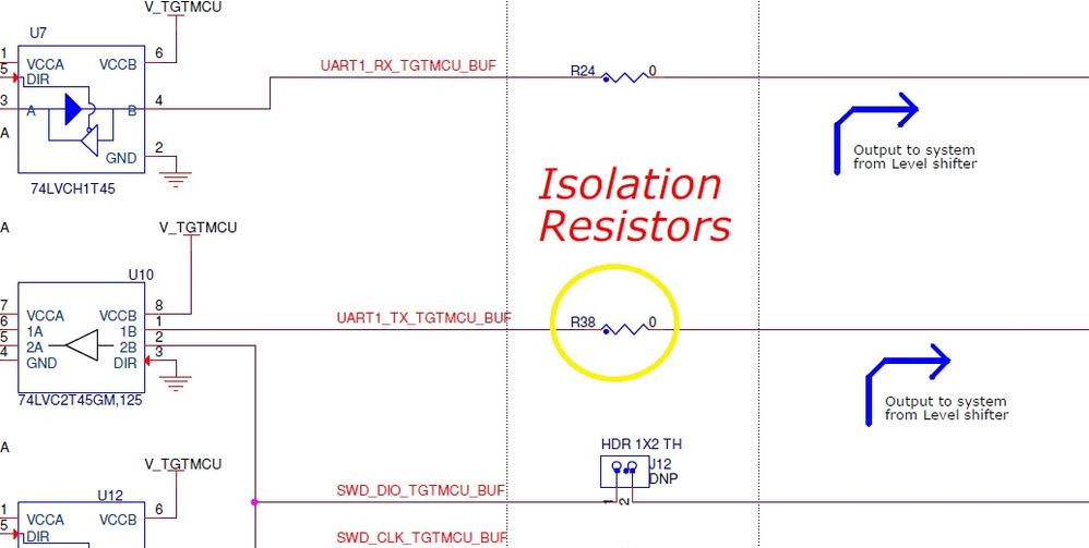

I was able to find what was happening with my FRDM-K64F eval board.  Sometime ago I wanted to work directly with the
K64F and wanted complete isolation from the OPENSDA side.  I had cut some traces, which I place jumpers just in the event I had
to go back.  Unfortunately for some reason, I also removed R38 from the board and I had forgotten about it.  From the FRDM-K64F
here is the portion of the schematic:
I circled R38 in yellow.  Today I placed a zero ohm resistor to complete the circuit and the demo is now communicating to
the Terminal software.  I will re-visit today the portion of code that was reporting a failure to see if that has changed now and hopefully
tie the loop.
I am still having issues though detecting the USB stick on my custom board and would like to know if you can guide me where
this happens in the demo software?  Where in the demo is the trigger?
Neil

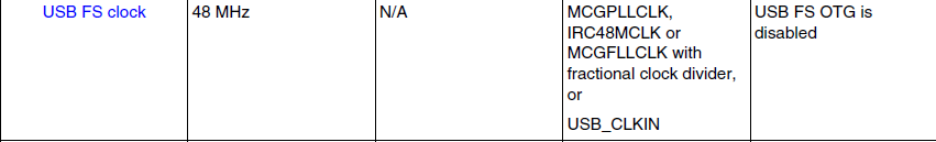

If I am using a 16MHz crystal vs the 50MHz signal for the EXTAL0/XTAL0, do you know all the different entry points that needs to change
on the demo software?
Neil
12,554 Views
danielchen
Hi Neil:
The USB clock should be configured to 48Mhz.
Please refer to the reference manual K64P144m120SF5RM.pdf.  p188
What is your USB clock source? I would suggest check the Freescale KSDK USB Stack Porting New Platform User's Guide. It is under the installation folder
KSDK_1.3.0\doc\usb\
12,554 Views
neilporven
Senior Contributor I
Hi Daniel,
The USB clock source is 48MHz.  I will take a look at the documentation you suggested.
