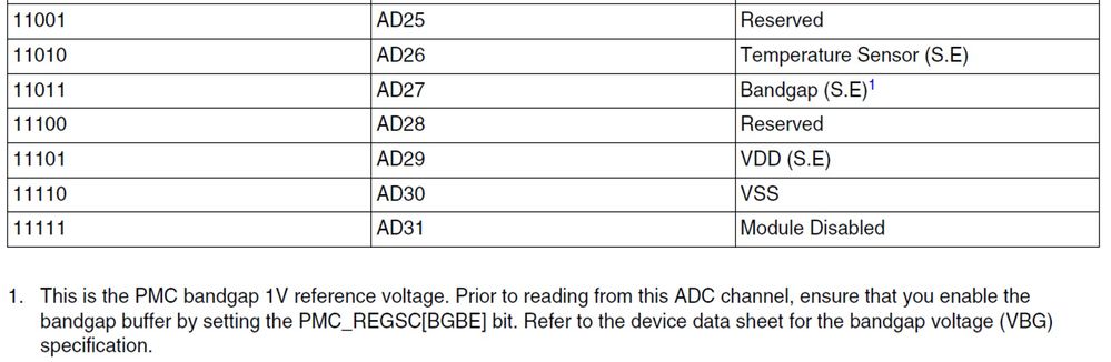

With ref to a mkl03z32 mcu, kds3.1 and ksdk1.3, when using the fsl_adc16 with the "Vref pair" as Voltage reference, the measure of the bandgap gives erratic measures...
It is so necessary to add the following code
    PMC_REGSC |= PMC_REGSC_BGBE_MASK;
    SIM_SCGC6 |= SIM_SCGC6_ADC0_MASK;
to make it operate.
Imho selecting the measure of the bandgap in the component should enable automatically the bandgap function, or at least show a warning!

Hello Michael,
The instruction SIM_SCGC6 |= SIM_SCGC6_ADC0_MASK; isn't necessary due it is already set in ADC16_DRV_Init function:
/* Enable clock for ADC. */
    CLOCK_SYS_EnableAdcClock(instance);
And for PMC_REGSC |= PMC_REGSC_BGBE_MASK, it is specified in Reference Manual's section 28.1.1 ADC0 connections/channel assignment a small note at the end of the table:
Bandgap note.jpgAnd when you specify A/D channel to be Bandgap (channel AD27) you only configure ADCH field for ADC0_SC1 register, so user should enable PMC bandgap independently because it is related to other module.
I hope this can help you!

Thanks Isaac, my problem is  (was with ksdk v2) the too easy use of Processor Expert that often makes me forget about hw and manuals...
