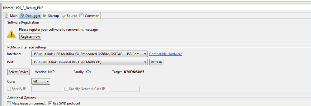

In my PCB design,  I need to program the K20 (K20DN63M5) on my PCB through JTAG physical interface with the  programmer device (P&E USB Multilink Universal).  Right now, The software interface I use to program is the Kinetis Design studio IDE (3.2.0,  go to " pull down menu 'Run -> Flash from file ...'") .  Is there a standalone software to be used for flash/re-flashing the chip in this case?  Is PROG12Z working for K-series chip?  Otherwise, what's your recommendation? Thank you.

Hi Daniel Cheng
PROG12Z is for HC12 or MC9(S)12(X). You can check PROG for ARM® Cortex in P&EMicro web page P&E Microcomputer Systems: Over 30 years as an Industry leader in Embedded Systems Development Tools...

I use Segger and they have a tool called ozone you can use it to directly program the chips.

Thanks. But we already have P&G USB Multilink Universal in place. Do you know if PROG12Z works with this chip?  Thanks again.

There is one other way to automate flashing by using gdb on the command line. Check this out :smileyhappy:
Command Line Programming and Debugging with GDB | MCU on Eclipse
