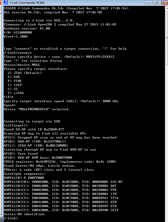

I am trying to programme MKE04Z128 controller by using PE micro universal multilink with MCU Xpresso IDE(updated version) ,facing use for connecting hardware.
i have connected connection like VCC,GND,SWD data and clock,RESET five connection,without any pullup resisitor
please refer the attached image
kindly help me to sort the issue.

Hi ravindra,
  Your MKE04Z128 is the customer board, not the NXP official board, right?
  If yes, please note these points:
  SWD_DAT, pull up 4.7k to 10K resistor.
  NMI, pullup 10K resistor
  reset_b pin, pull up 4.7k to 10K resistor, and 0.1uf capacitor.
 About the debugger, do you have the JLINK on your side? If yes, I suggest you try JLINK, and the JLINK command can help to check whether your board can find the ARM core directly, if you can't find the ARM core, it means your hardware still have issues.
The above is the JLINK connection example.
 Please try it on your side.
If you still have questions about it, please kindy let me know.
