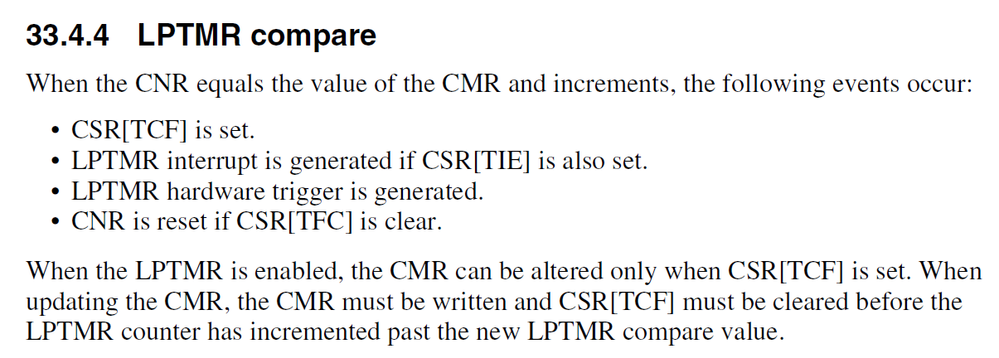

Hello ,
This is basically an ISR doubt.
I am trying to interrupt when there is a timer overflow.
But, it never goes to the ISR. Kindly suggest some solutions pls -

xiaodong_zhang
hi karuvat,
I guess you miss TCF bit of LPTMR0_CSR. You can refer to the following.
