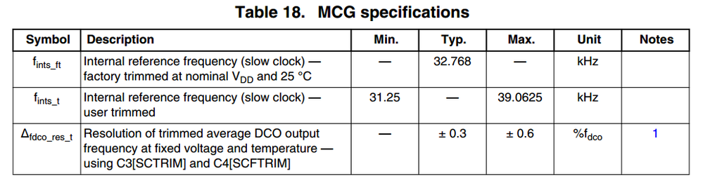

I use
MKL26Z256VLL4 micro -  clock 8Mhz
I use  as RTC_CLKIN (pin PTC1) the output of pin PTC3
I set MGGIRCLK with souce 32KHz IRC
As you can see in Clock and RTC SET
I have a RTC time error - about 2 minutes x day
I see that PTC3 output a 32898 hz signal
instaead of waiting 32768 hz. (see RTCinput.jpg)
I have tried to adjust this signal
changing the value of  slow internal reference clock but no result
Can you give me some support?

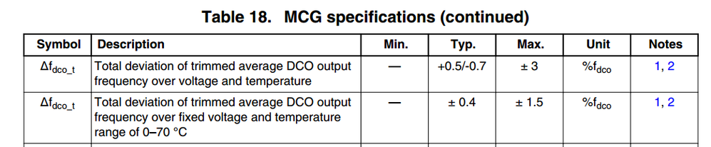

Please refer KL26 datasheet about the internal slow clock accuracy data:
If customer want more accuracy RTC clock, it need to use external 32.768KHz crystal or oscillator.
Thank you for the attention.
