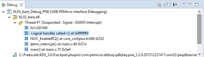

Here are some code bits.  Here is the basic interrupt enable.  Lines 143 and 144 execute but when 145 executes
the processor goes off into unknown territory.  When I suspend operation the condition is always:
When I click on NVIC_Enable I see:
the setup for the LPTMR is for regular interrupts so I can check some inputs.  My interrupt routine is:
but the interrupt routine is not being executed.
If I comment out the NVIC_Enable the program executes, but off course no interrupts occur.
The warning is for a break point which I cannot seem to clear.  I have tried it using both interrupt number 28 and LPTMR0_IRQn and they both do the same thing.
It seems to me that the interrupt routine is not being identified properly so that upon interrupt things fall apart.

NMI is "non-maskable" so it will aready fire before you enable interrupts in case the pin is '0' at any time after reset and before reprogramming its function.
If you don't need to use the NMI you can disable its operation by setting the NMI_DIS bit in the FOPT byte of the flash configuration.

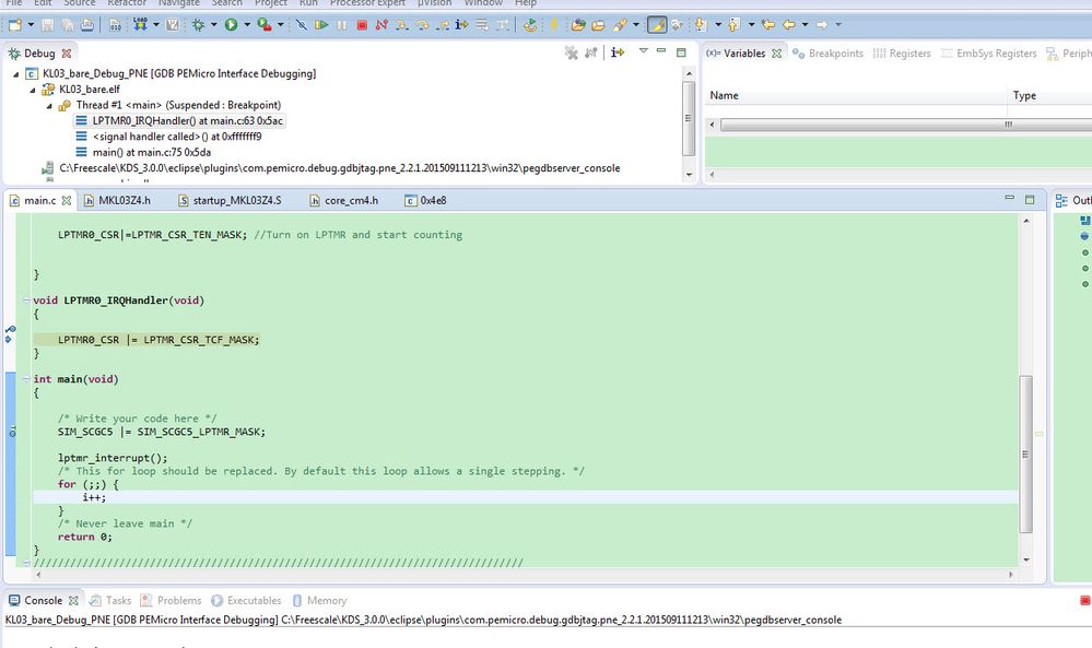

When I load your project after running from the first interrupt and suspending operation I always get:
If it were running correctly I would think that when I suspended operation I would either be in the interrupt service routine or in the main loop.  When I add a counter to the LPTMR interrupt routine it never increments.
I can install the code without the statement     NVIC_EnableIRQ(28); and it will load and run but of course it will not get LPTMR interrupts.  When suspended it is in the main loop.

stevengarfinkel
I loaded your project and in my embedded system it does the same thing as before.  I am wondering if it is because I am using the 8k part using the frdm -kl03z board as the PNE interface.  Perhaps it is trying to put the interrupt vectors into memory that doesn't exist.  I will make a system with the 32k part and see if it works.

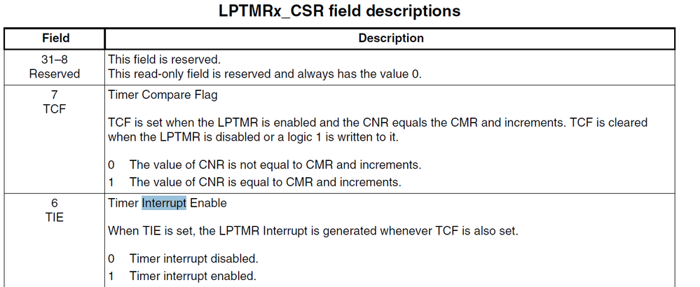

Hello Steven,
Please check whether you enable the LPTMR interrupt through the register of LPTMRx_CSR->TIE,
and the check whether the interrupt occur through the TCF :
if the two points are right , you can send your project to me , i will check it on my side.
Alice Yang
10,988件の閲覧回数
stevengarfinkel
I have TIE enabled.  Thanks.
