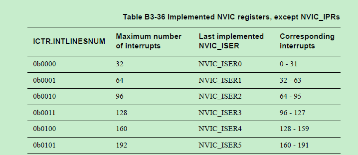

I checked the CAN0 and CAN1 interrupt setting code with problem.
As ARM Cortex M4 core shows the interrupt set-enable registers shows the IRQ number (IRQ) with related register:
For the CAN0 interrupt IRQ value from 75 to 80, which need to use NVIC_ISER2 register to enable CAN0 interrupt.
The CAN1 interrupt IRQ value from 94 to 99, which need to use NVIC_ISER2 and NVIC_ISER3 to enable related CAN1 interrupt.

Wish it helps.
Ma Hui

j_cfernandez
thanks for the answers.
I set the numbers correctly. But doesn't work. In the Register i can see the data.

I init the CAN 0 Int.:
  NVIC->ICPR[ 0 ] = ( NVIC->ICPR[ 0 ] & ~(((uint32_t)0x07)<<29)) | (((uint32_t)0x07)<<29);  /* Clear pending interrupt CAN0 */
  NVIC->ISER[ 0 ] = ( NVIC->ISER[ 0 ] & ~(((uint32_t)0x07)<<29)) | (((uint32_t)0x07)<<29);  /* enable interrupt CAN0 */
  NVIC->ICPR[ 1 ] = ( NVIC->ICPR[ 1 ] & ~(((uint32_t)0x1F)<<0))  | ((uint32_t)0x1F);   /* Clear pending interrupt CAN0 */
  NVIC->ISER[ 1 ] = ( NVIC->ISER[ 1 ] & ~(((uint32_t)0x1F)<<0))  | ((uint32_t)0x1F);    /* enable interrupt CAN0 */
I init the CAN 1 Int.:
  NVIC->ICPR[ 1 ] = ( NVIC->ICPR[ 1 ] & ~(((uint32_t)0xFF)<<5))  | (((uint32_t)0xFF)<<5);  /* Clear pending interrupt CAN1*/
  NVIC->ISER[ 1 ] = ( NVIC->ISER[ 1 ] & ~(((uint32_t)0xFF)<<5))  | (((uint32_t)0xFF)<<5);  /* enable interrupt CAN1*/

j_cfernandez
Dear,
it`s working fine.
Thank you
