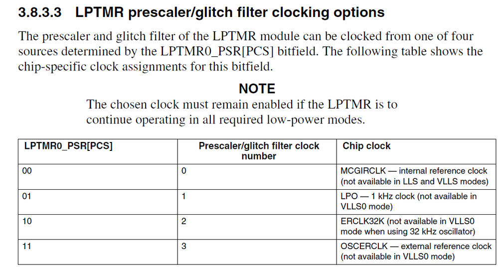

Hello Friends,
I have an unusual problem :smileyhappy:
I have designed 3 boards (variants of he same app) using the KL04 chip. Now the code used is this -

Ideally the controller should be interrupted and the control should go to the ISR (void LPTimer_IRQHandler(void)). What I see here is that in the 1st and the 2nd version of the board the ISR works well. But in the 3rd it doesnt. So, to test the 3rd board I made a pin toggle which is executed fine making me feel that this is a purely software issue.
I am a bit confused as to how this is being done.

Hi, Vinod,
Regarding your question, I have not the FRDM-KL04 board on hand, but I have FRDM-KL02Z board, I have tested the code on my FRDM-KL02Z board, I found out that the LPTMR0_PSR[PCS]=11 in binary for unknown reason  in default state, in the case, it selects the OSCERCLK as clock source, in the case, you should set the OSC32KSEL in SIM_SOPT1 as 10 in binary, in the setting, the CLK source for LPTMR will be from external RTC_CLKIN as Mr Yasuhiko pointed out, pls refer to section 3.8.3.3 LPTMR prescaler/glitch filter clocking options in RM of KL04. But if you use RTC_CLKIN pin, you have to enable PORTA clock in SIM_SCGC5 and set the PORTB_PCR4 = 0x00000100; and set the SIM_SOPT1 =0x80000;
I have developed the code based on the FRDM-KL02 board, with which I can enter the LPTimer_IRQHandler(void) with 1KHz LPO clock source, you can copy the code directly for KL04.
I attach the code, hope it can help you.

xiangjun_rong
Hi, Vinod,
as you know, multiple clock source can drive the LPTMR, pls check the LPTMR0_PSR[PCS] to determine the clock source the LPTMR uses for your old code, I guess the LPTMR uses LPO, whatever.
Pls refer to the section I copied from UM of KL04.
XiangJun Rong

Hi vinod,
I guess your board has neither EXTAL0 nor XTAL0 oscillator. In the case, the setting SIM_SOPT1 0 would not select any clock for LPTMR. How about 0x000c0000 (i.e. LPO) as SIM_SOPT1 value? Also you should better make the first LPTMR0_CSR setting not 0 but 0x80 to clear the interrupt.
