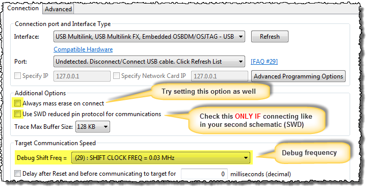

  7. Before programming we need to mass erase the controller otherwise it will be in continuous reset mode. And to do that we need to configure SWD/JTAG mode. The following configurations for K20P48 LQFP in SWD mode.

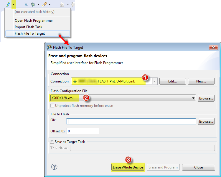

  8. For mass erase following steps we need to follow.
    Search for thunderbolt icon in code warrior ie flash programmer and click on the drop-down menu on the icon.

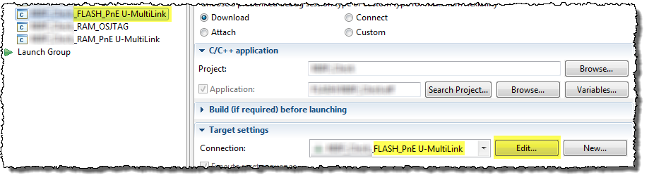

  11. Click on edit then
  13. After configuring the above settings then click on the erase whole device option shown on step 9.
