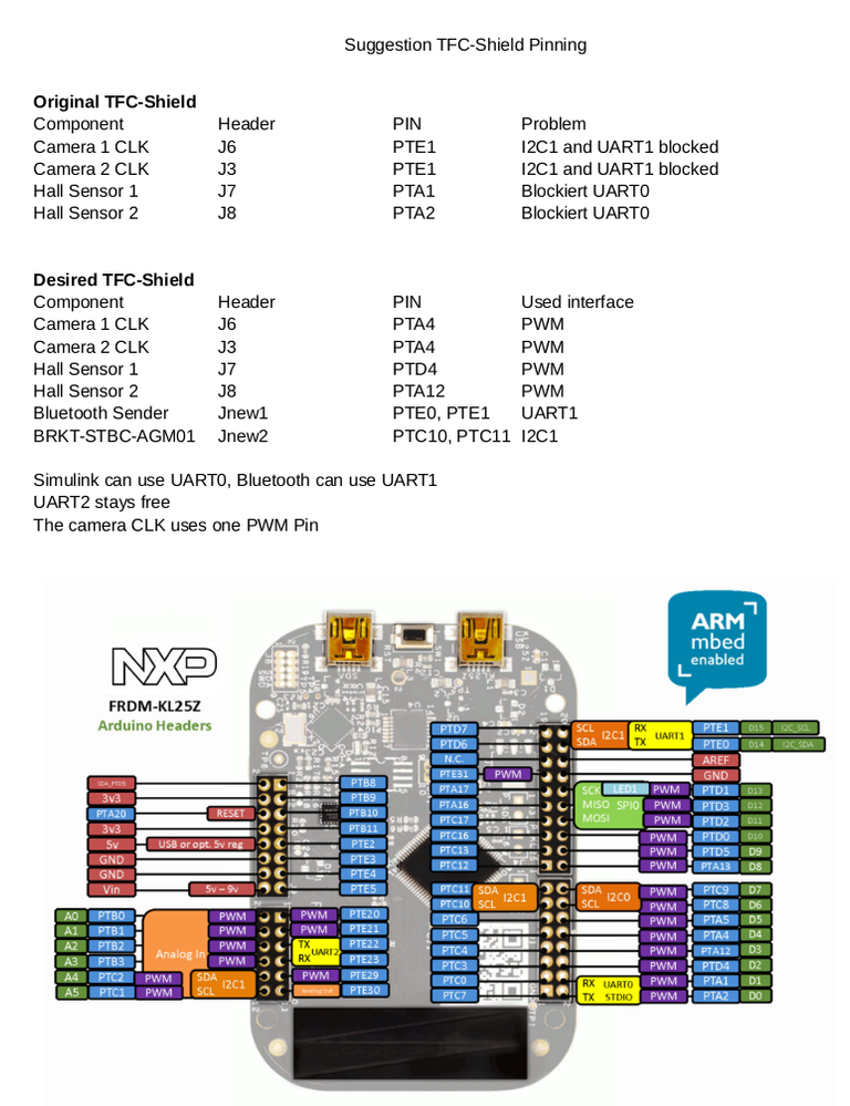

Hi guys,
I am wondering if one ever thought the pinning of the TFC-Shield can be a bit inconvenient. When you wanna add some other sensors, then the camera clock blocks the UART1/I2C1 and the hall sensors block the UART0. So for example when you wanna add the gyro and magnetometer of the BRKT-STBC-AGM01 the you have a problem. Moreover, if you wanna work with Simulink then UART0 is used by the external mode.
So I was wandering if anybody has the same issue and if there will be a new version of the TFC-Shield available or if anyone is interested to design an updated version. We would be very interested to add a gyro and magnetometer as well, since we design an IMU for the car. I have attached a pic which provides information about our desired pinning.
BR,
Gehard
