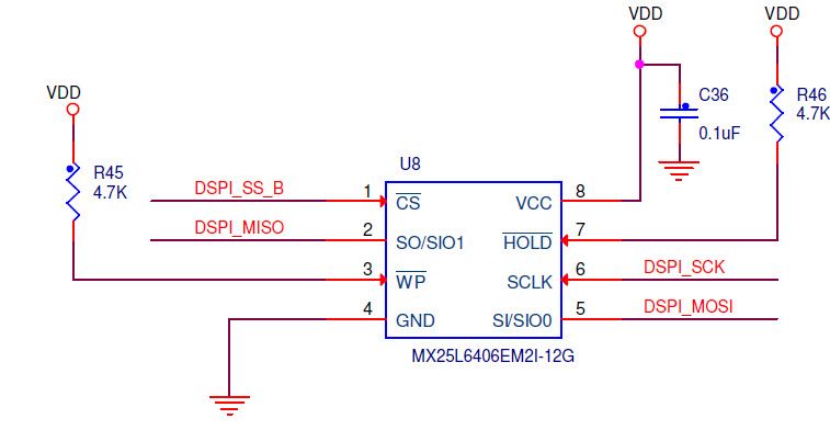

External flash MX25L6404EM2I circuit:

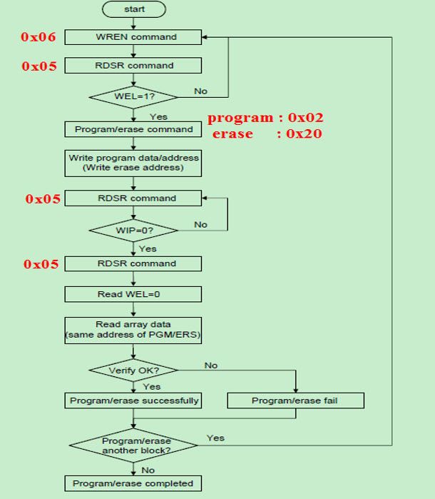

3 Code realization for external flash operation command
    At first, refer to the external flash program / erase flow, then I will give the according command code realization one by one.
Take flash sector erase flow as an example, the according code is :
void hal_spi_dev_flash_erase_sector(uint8 addr)
write_enable();      // WREN command
spi_wait(WEL);     // RDSR command and wait WEL=1
hal_spi_transfe_start();    // enable CS pin , CS=0
hal_spi_transfer_one_byte(CMD_SECTOR_ERASE);   // erase one sector (4KByte)command
hal_spi_transfer_one_byte(addr>>16);  // address
hal_spi_transfer_one_byte(addr>>8);
hal_spi_transfer_one_byte(addr>>0);
hal_spi_transfe_stop();  // disable CS pin, CS=1
spi_wait(WIP);    // RDSR command and wait WIP=0;

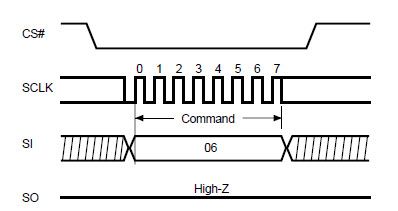

(1)Write enable (WREN) command : 0X06
static void write_enable(void)
    hal_spi_transfer_one_byte(CMD_WRITE_EN);  // Send WREN command

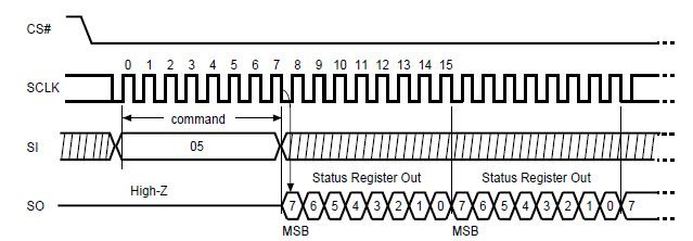

(2)Read status register (RDSR) sequence: 0X05
static void spi_wait(uint8 CMD)
if(CMD == WEL)
while(get_sr()&0x02 != 0x02); // wait until WEL bit =1
else if(CMD == WIP)
while(get_sr()&0x01 != 0x00); // wait until WIP bit =0
static uint8 get_sr(void)
    uint8 v;
    hal_spi_transfer_one_byte(CMD_GET_SR);  // Send RDSR command
    v = hal_spi_transfer_one_byte(0x00); // read states register data
    return v;

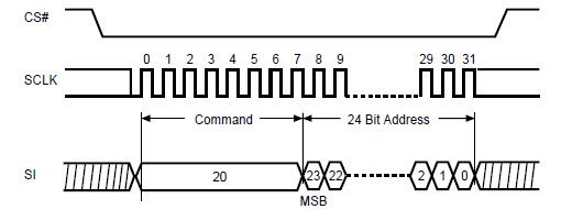

(3) Sector erase (SE) sequence: 0X20

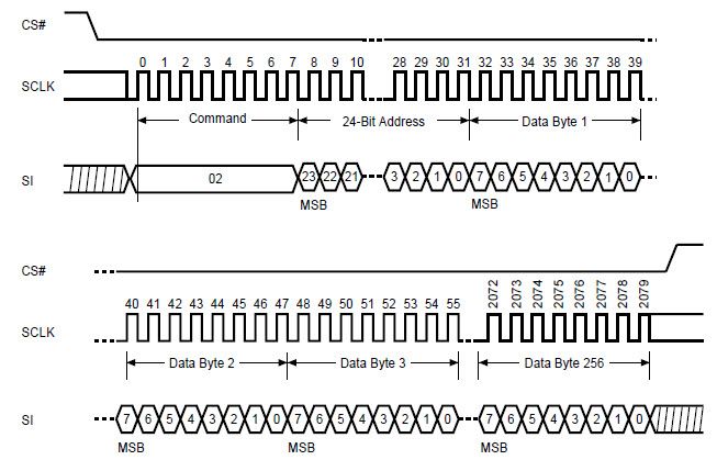

(4) Page program (PP) sequence : 0x02
#define PAGE_SIZE 256
    hal_spi_transfe_start();// enable CS pin , CS=0
hal_spi_transfer_one_byte(CMD_PROGRAM); //send flash program command
hal_spi_transfer_one_byte(addr>>16); // flash page base address
for(i=0;i<(PAGE_SIZE-1);i++) // send program data to the flash page
hal_spi_transfer_one_byte(buf[i]);
  hal_spi_transfe_stop();// disable CS pin, CS=1

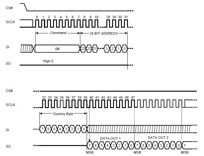

(5) Read at higher Speed(FAST_READ) Sequence: 0X0B
void hal_spi_dev_flash_read_page(uint8 addr, char *buf)
int i;
hal_spi_transfer_one_byte(CMD_READ); // read command
hal_spi_transfer_one_byte(addr>>16);  // base address
hal_spi_transfer_one_byte(0x00); // dummy byte
for(i=0;i<(PAGE_SIZE-1);i++)    // read data back from the flash
buf[i] = hal_spi_transfer_one_byte(0x00);

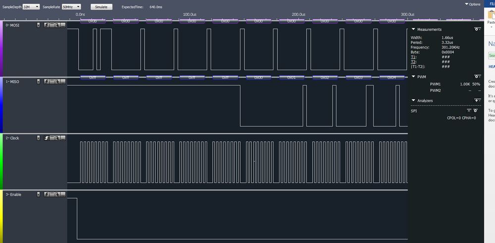

The following wave is the page read data out after flash page program.
The attachment is the testing code.
