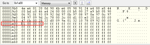

Then it will program erase cycle value to each sector start address, the erase cycle value will occupy 4 bytes with sector start address offset 0:

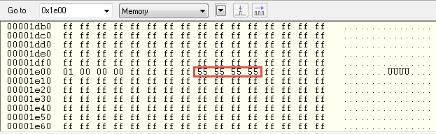

Then make the base sector to be active and program the active indicator at sector start address offset 8. Here the base sector start address is 0x1E00, the active indicator will be programmed at 0x1E08 with active indicator value 0x55555555:
Then it will call Eed_SearchBlankSpace () function to find blank space of EEPROM system, in this demo, the blank space start address at 0x1e0c.

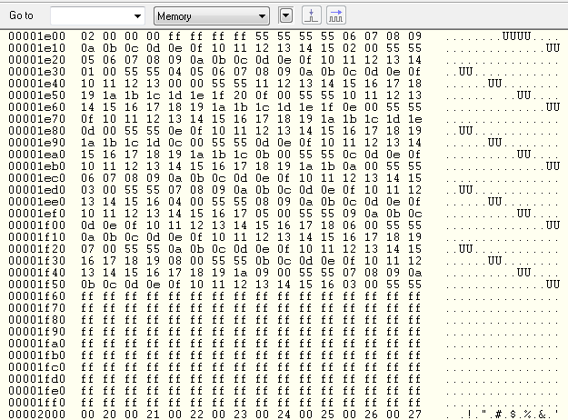

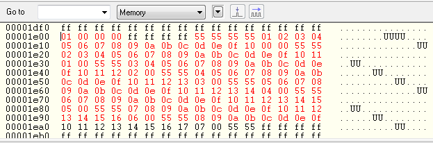

The demo will write eight group data to EEPROM system, each group with 16 bytes data, total data number is 128 bytes. The data located at Flash start address is 0x1e0c. After each group data programming, it will following with the data ID info and program the status.
With all data was written, the all 128 bytes data was programed at 0x1e00 start EEPROM sector.
When the write data exceed the active EEPROM sector, the swapping will occur. The swapped EEPROM sector will record previous data and current write data. If there exist sector erase action, it will also update the erase cycle value.
