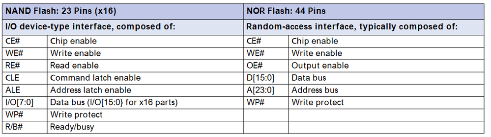

I need add an sternal NAND Flash to Kinetis MK64 or MK66. I see these MCU do not include NFC but include Flexbus. So, its possible add a NAND Flash using Flexbus, or better I use MK60 or MK61 with NFC ?

FlexBus can't work directly with NAND - it would need to bit-bang various signals, making it rather inefficient.

OK, thanks Mark.
Then best solution is use NOR Flash with Flexbus, or NOR Flash also do not need Flexbus ?.
I have check already a MICRON JS28F512M29EWHA NOR Flash, TSOP56, 512 Megas, perfect for my requirements.
I do not have experience with Flexbus, so I do not know really what's useful.
