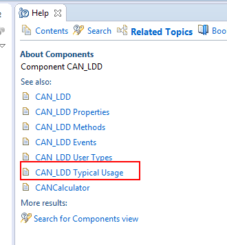

Hello Andrew,
1. Does the error show when you only add the CAN_LDD component , click generate button , the build the project ?
(if yes ,  pleas screenshot to me how do you operate step by step , i just test it on my side , it with no error .)
2.No, you needn't , only connect the 1-1 ,2-2 between the two board.

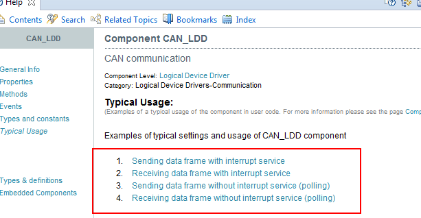

3-4. About the use the  CAN_LDD , there are demo code, it includes the interrupt mode :
    please right click the CAN_LDD component ->select the "help on component "-> "CAN_LDD Typical Usage"
Please refer to the configuration and code .
