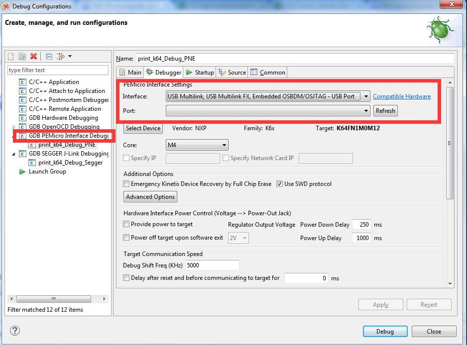

Hello Eduard,
Please first check the debug configurations on KDS, make sues it detects you multilink :
(the picture not detect the multilink )
And what about your board , it is a demo board or custom board ?
