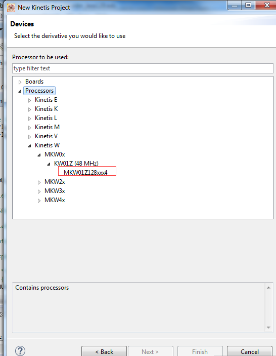

I was wondering if anyone out there was targeting the MKW01Z128 with KDS.    And if so is the MKL15Z128xxx4 the closest core variant in KDS that lines up with the MKW01Z128?

Even I am targeting the MKW01Z128 with KDS. Have just bought the freedom board FRDM-KW019032 but do not know how KDS can be used for the same.

Yes, the KDS support this chip .

Thank you Alice, that is helpful. But as I checked KDS doesnt support the FRDM-KW019032 under the boards category, so does that mean I will not be able to program the board? What is the difference in having a board project & a processor project in KDS?

We can use the KDS develop the board of FRDM-KW019032 .
On KDS , select the"board " and "processor" boards are OK , it doesn't matter .
In generally , i select the "processor" .
