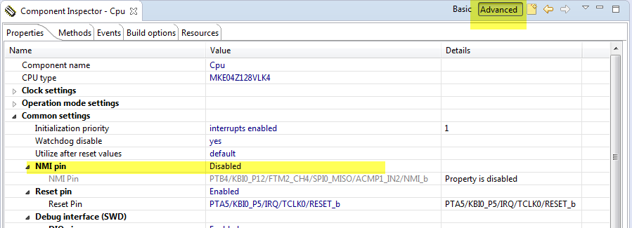

Good afternoon,
I need to disable the NMI from reset.
How to implement in KDS?
Thank You
1,736 Views
ZhangJennie
if you use processor expert, we can disable NMI pin in CPU component setting.

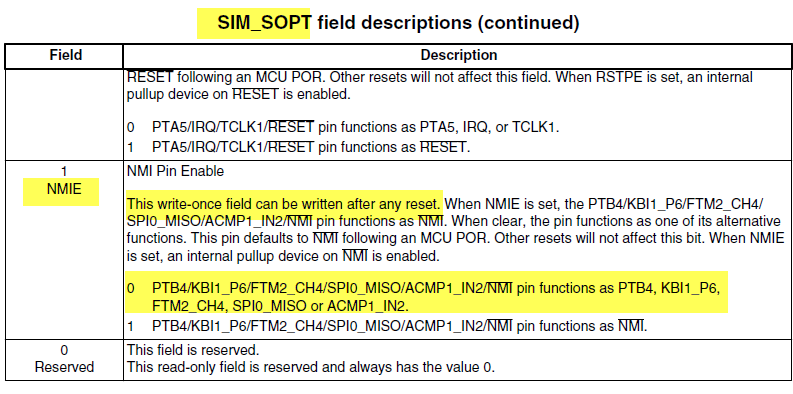

if you doesn't use processor expert. we can set SIM_SOPT NMIE bit as 0 to disable it after reset. see below from reference manual
please note, NMIE is write-once only on each reset. it can only be written after reset.

davidsherman
Senior Contributor I
I'll add that there's another setting under CPU interrupts to disable the NMI interrupt, this also needs to be unchecked in addition to the NMI pin setting.  I had to do this as well.

george_ch
Thanks.
I would like to disable NMI from reset.
Your solution disables NMI after reset has occured.
George
1,736 Views
davidsherman
NMI is always enabled at reset, read the Kinetis documentation.  It must be disabled after reset.  For this reason, you have to make sure the pin isn't pulled low at power up or you'll be stuck.
