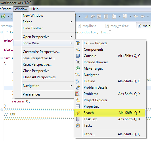

The problem that I am having is basically summed up by the title - I cannot use Search Text, References, or Declarations in order to find a variable or line of code within my project, because the window that should be popping up with the results is nowhere to be seen. I'm fairly certain that this is not a simply problem such as the window being minimized; I have tried navigating to Window -> Show View in an attempt to bring up the window but have had no luck.

Hi Kevyn,
Please try resetting your perspective:
And then try opening the "Search" window again:
Hope it helps!
