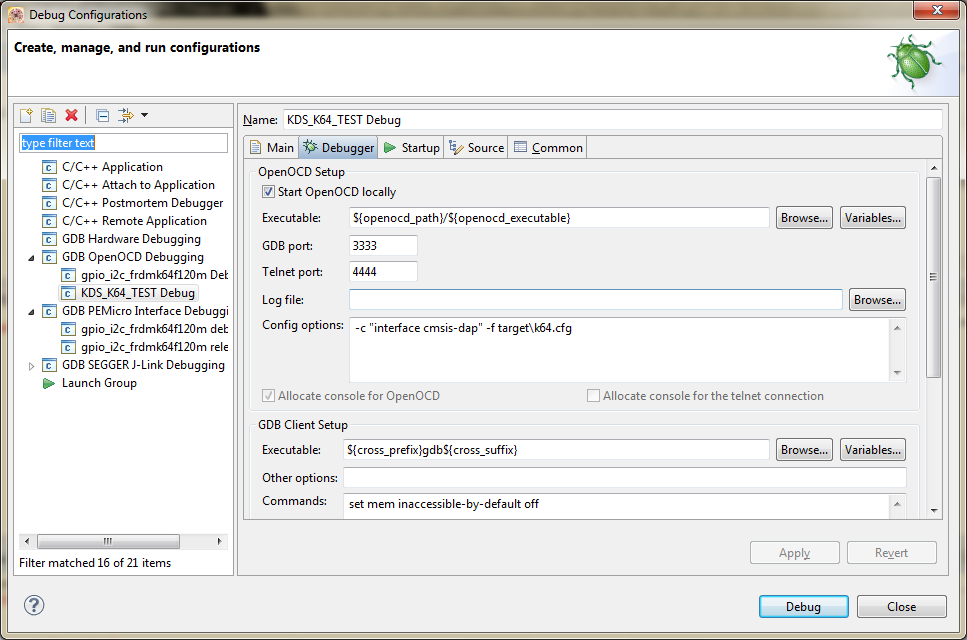

HI, KDS experts
I download the KDS 1.1.0 version last week, create a simple project of FRDM-K64 try to debug via OPENOCD, CMSIS-DAP, strangely it's failed but back to KDS 1.0.1 there is no such issue.

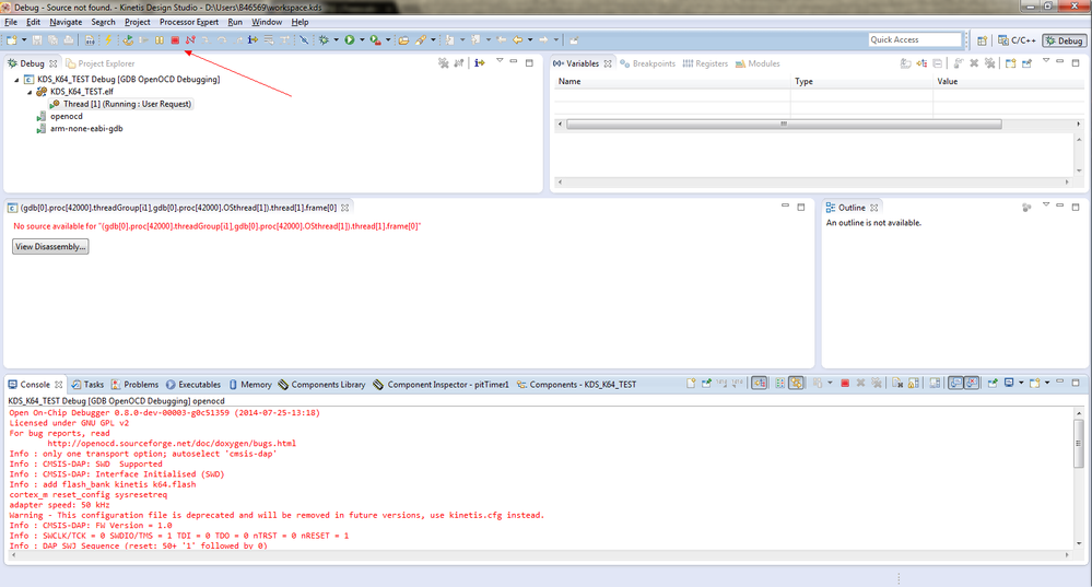

The program cannot download in chip but in KDS the state is RUN without stop before main, meantime, the green-led of SDA on board is blinking. but program still hasn't downloaded.
below is my setting and failed infos

and this is my debug configuration of OPENOCD
About config options, I use "-f kinetis.cfg" before, but make no sense,too.
But KDS 1.0.1 was fine.
Please help, thanks a lots!

Further comment on your debug screenshot: what does it show if you press the 'pause' button.
I suspect you might not have allocated enough HEAP space in the linker file, and that the program is stuck in the startup code?

with KDS V1.1.0, you really should use
-f kinetis.cfg
I have posted an example in this thread using printf:
First impression with KDS 1.1.0 Can't Debug FRDM-K64F with OpenOCD/CMSIS-DAP
which has all the debug configurations (Segger/J-Link/OpenOCD) configured.
Can you try it?
