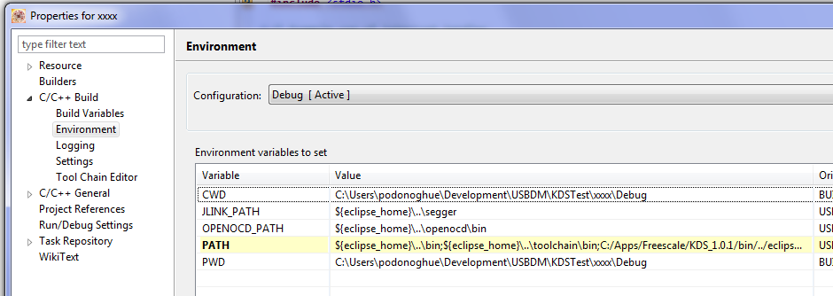

Hi Erich,
Thank you for forwarding my comments.
I'm unsure what you mean by "PATH on your environment at the system level".
If you mean in the window's environment I don't believe this will work (I haven't tried it).
If you open a project settings as shown it appears the method used pre-pends the paths to the tool directories to the PATH environment:
This would apply to all projects and is ahead of any system paths.

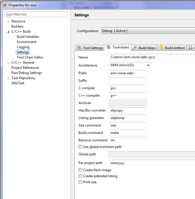

Even modifying the path in the project settings (where it should be set) is defeated:
The only method I know of that works would be to use the same hack and create a new plugin that load AFTER the KDS one and modifies the path i.e. hack the hack :smileyhappy:.
Not really elegant.
bye

BlackNight
How to use GNU gcc ARM Embedded with KDS: Switching ARM GNU Tool Chain and Libraries in Kinetis Design Studio | MCU on Eclipse.
Still not as elegant as choosing the tool chain in Eclipse, as it means swapping/renaming folders, and it would be effective for all projects. But at least works and I can use that way the latest and greatest ARM launchpad tools with KDS.
