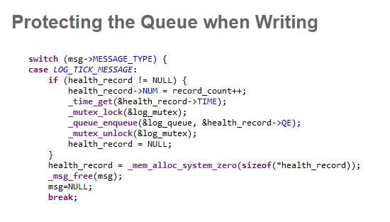

    1. In the while(1) loop of the Health Task where the LOG_TICK_MESSAGE message types are processed is where the Health Records are added to the queue using the _queue_enqueue() function. Since the job of the mutex is to prevent simultaneous access to the mutex, just before the record is logged is where we want to lock the mutex. And immediately after the Health Record has been added to the queue is where the mutex should be unlocked since we're done accessing the queue for now. Use the _mutex_lock() and _mutex_unlock() functions for this.

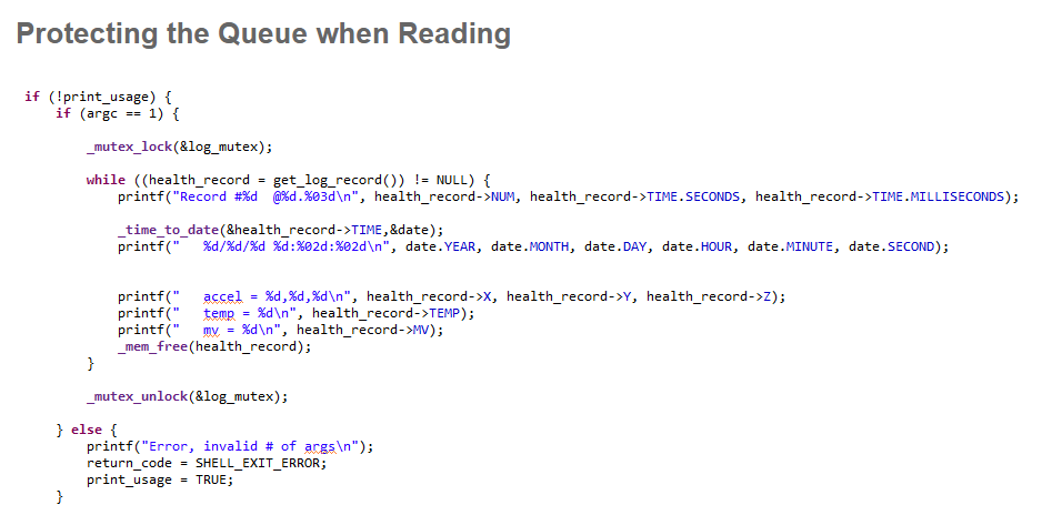

  1. The UI Task traverses the list of Health Records in the queue when the user requests that the logs be printed. This is done in the Shell_log() function. Use the _mutex_lock() and the _mutex_unlock() functions to protect the queue for the entire time that the list is being traversed.

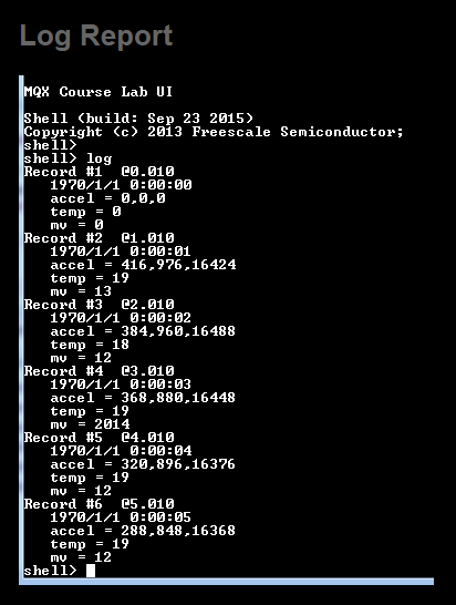

  2. Compile and run your code. You first may want to comment out any periodic print statements. Use the 'log' function in the shell to see a print out of logged Health Records and ensure that a new record was being made every second.
