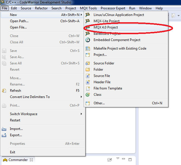

Hello Freescale,
I installed MQX 4.1 with CW 10.5 but I couldn't see new MQX project wizard in CW. I didn't have this project in MQX 4.0.2.
Is this feature supported in 4.1?
Cheers,
Sina

Hi Sina,
MQX 4.1 was developed to work with CW MCU v10.5. It has been tested and confirmed to work with CW MCU v10.6.
please
- uninstall your CW and MQX
- restart computer
- install CW10.5
- install CW10.5 update
- install MQX4.1
- restart computer
see how it works?
