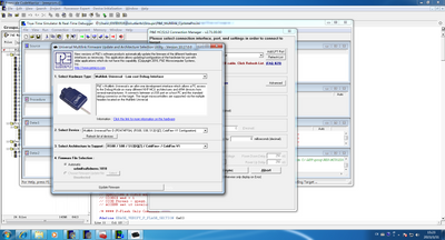

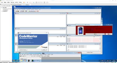

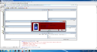

When I debugged the.mcp project using MultiLink Universal and Code Warrior V5.0 and V6.2, I got an error after clicking the Connect(RESET) button and the following firmware upgrade failure message. In fact, I have already used PEFirmwareConfig.exe to update the firmware of MultiLink Universal from ARM to S12 type (because my target chip is MC9S12XEP100 and it use S12 architecture), I don't understand why the firmware is required to be upgraded again in Code Warrior IDE and cannot be debugable if the upgrade fails. The following is the corresponding picture, I hope someone can help me, thank you.
First update Firmware:
Second try to debug
Click no:

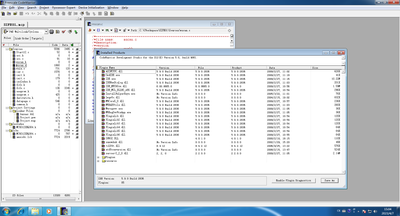

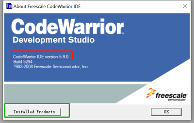

What's the difference between Code Warrior and Code Warrior IDE? And where can I check my Code Warrior version instead of my IDE version? According to the instructions in the video, I found that I did not purchase the corresponding software, so the Product list only has MCUXpress.

5.9.0 is IDE version, but not CW version
to check CW version, click on "install products" you will see.
If you have CW for HCS12(X) v5.2 license, it also works for CW5.1. No need to purchase license again.
