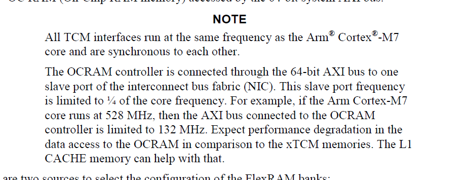

According to the user's manual for the i.MX RT 1060 the OCRAM (FlexRAM) occupies the address range from 0x20280000:
The FlexRAM default is to have 128k DTC, 128k ITC and 256k OCRAM and its OCRAM2 is fixed at 0x20200000 (512k).
When I try to use OCRAM I find that there are access errors on all addresses in the OCRAM (FlexRAM) range, although ITC and DTC accesses are OK (in their 128k default ranges), as are accesses in OCRAM2 area.
If I then reconfigure the FlexRAM I can configure both ITC and DTC to have sizes of 32k..512k, as expected but no matter what size is allocated to the OCRAM it can never be accessed. If I allocate all of FlexRAM to the OCRAM there is neither ITC nor DTC (correct) but there is still no OCRAM in the area.

I have been following the application note, which matches for the i.MX RT 1010, i.MX RT 1020 and i.MX RT 1050. It however doesn't match for the i.MX RT 1060 or i.MX RT 1064.
According to the default for both RT105x and RT106x there should be 256k of OCRAM available after reset (when the eFuses are left in the default state):
If one connects to the board with a debugger one can read and write in the areas 0x00000000..0x0001ffff [128k ITC] and 0x20000000..0x2001ffff [128k DTC], and also in the area 0x20200000..0x2027ffff [512k OCRAM2 fixed], but one can't access the area 0x20280000...0x202b0000, which should be the default 256k OCRAM FlexRAM.
This is a very simple test to do (doesn't even need code). Do you manage to use/access the OCRAM or access any memory in the area 0x20280000...0x202fffff?
I can then reprogram the FlexRAM to allocate different sizes of ITC and DTC and OCRAM [all according to the application note, which does work on the i.MX RT 105x] and it works normally for the ITC and DTC but there is never OCRAM available.....

If you open a memory view in IAR do you see it at that point where you stopped?
It seems that this is an IAR problem since when I try to view the OCRAM (FlexRAM) memory it shows this:
0x2027fff8 is the last line in OCRAM2.
And after that it display just dashes, as it does when it can't access memory.
However when I add a read/write test to the code itself it works.
Also, when I do the same in MCUXpresso's memory viewer I "can" see the memory.
Before I had always trusted IAR's viewer but - especially if you can confirm - it must mean that they have set something up incorrectly to automatically block accesses in the OCRAM area. Potentially it also explains another problem I had with the i.MX RT 1015 where I couldn't view memory after a certain address!

   The same viewpoint with you, I also find the IAR memory problems yesterday, that's why I printf all the data out and show to you, I think it is the IAR bugs.
   But the MCUXpresso IDE can show the related address:
So, normally, when I meet the IDE can't show the memory data, I will use the printf to test it again, just make sure it is not related to the IDE. About the RT1015, I think you can test it the same way instead of just use the IDE memory window to check it.

Yes, I agree that this is an IAR bug.
Today I completed work on the i.MX RT 1060 whereby I boot up with the stack pointer at the top of OCRAM and then switch to it at the top of DTC after re-configuring the FlexRAM to allocate 480k TDC and 32k ITC (when the program code is less that 32k, or dynamically to suit the best mix between code and data).
It was not possible to watch the details in IAR (due to its viewing problem) but the operation was successful, showing that all FlexRAM is there and does work as it should.
