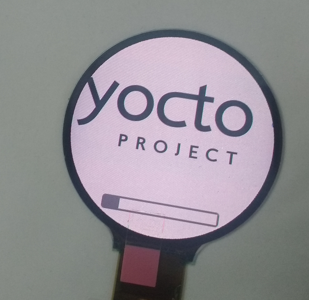

nandishguruling
Hi  Bharghavi K,
What you see in the above pic is Plash Screen not Boot logo,Then you need change the Plash Screen,please do the following steps :
convert yourimage.* to yourimage.h, then follow below steps,
1) copy the myimage.h to ../../../sources/poky/meta-yocto/recipes-core/psplash/files/myimage.h.
2) MACHINE=your-machine-name  source fsl-setup-release.sh –b build –e fb.
3) bitbake your-image-name.

bhargavik
Hi nandish,
Thank u,I converted the image .* to myimage.h.Copied to fsl-community-bsp/sources/poky/meta-yocto/recipes-core/psplash/files/
While executing ->MACHINE=wandboard  source fsl-setup-release.sh -b build -e fb
I'm getting as like below mentioned.
bash: fsl-setup-release.sh: No such file or directory.
How can i solve this issue?
Thanks in advance.

nandishguruling
Hi  Bhargavi K,
Step1:
First you need to change the image format from ( * = your image name)
a) *.png  to *.pnm
b) *.pnm to *ppm
Step2:
Replace the your converted *.ppm file with original  *.ppm file  in .../git/driver/video/logo/*.ppm
Step3:
Recompile your zImage or uImage or Image (The one which Image you are using for your board). by using your Cross Compiler,  Now Task is done and re-flash the image to your SD-card,
I hope i am clear with this, after done this task if not please let me know ,
Nandish SG
