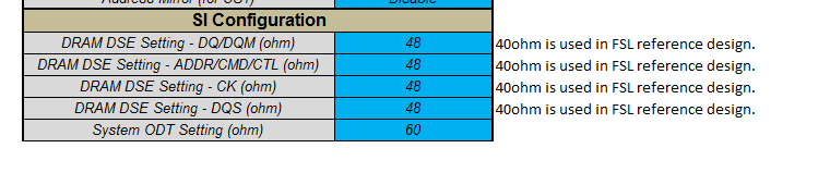

Thank you for enlightening information. I have run the stress test for 400MHz with over night option for 15 hours (about 720 iterations) and it succeeded. For the address range from 1000_0000 to 5000_0000, i tried memory read/write option of the tool, for some specific addresses like 2FFF_FFFF, the program freezes. Furthermore, i dont lose otg connection as in the case mentioned above. What might be the cause of this issue?
Aside of this, is there any method to adjust drive strength, ODT on both CPU and RAM side for optimal performance?
DDR Stress tester already passes with the values given as a parameter in the excel aid no addition drive strength settings arent made on the CPU side.

Regarding drive strength settings, these can be added manually to script.
igor
