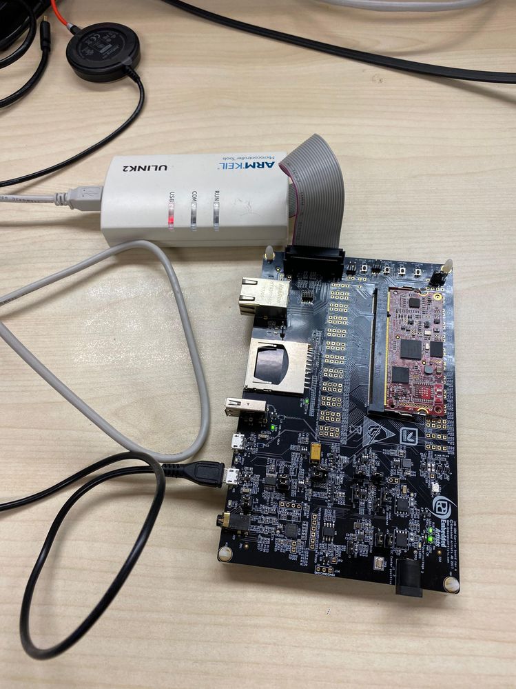

My development env is  as below:
1. window 10.
2. MCUXpressIDE MCUXpresso IDE v11.1.0 [Build 3209] [2019-12-12]
3.  i.MXRT1052 EVBK.
4.  debug probe:  Keil Ulink2  CMSIS-DAP
5. Attached picture shows  development board and debug probe.
6. Tera terminal  is opened for  USB-to-UART console.

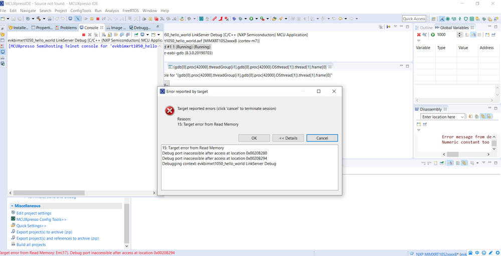

It is noticed that I can not have demo app  of  "hello world" to run normally  on this board in this circumstance.

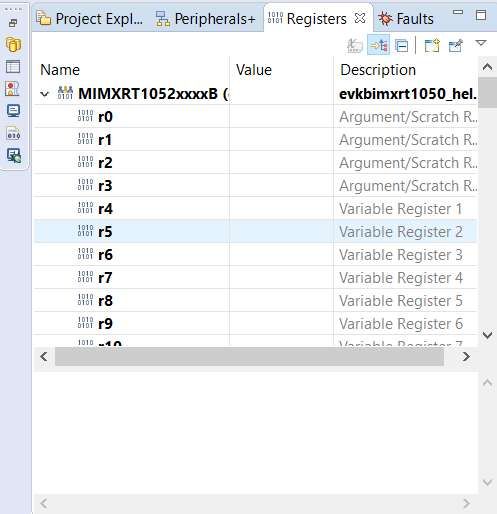

There is no "hello world" output  on Tera terminal and no same output in  IDT console.  In the meanwhile,  it seems that it is not quite right with debugger function in this case.  Detail info can refer to the attached files.

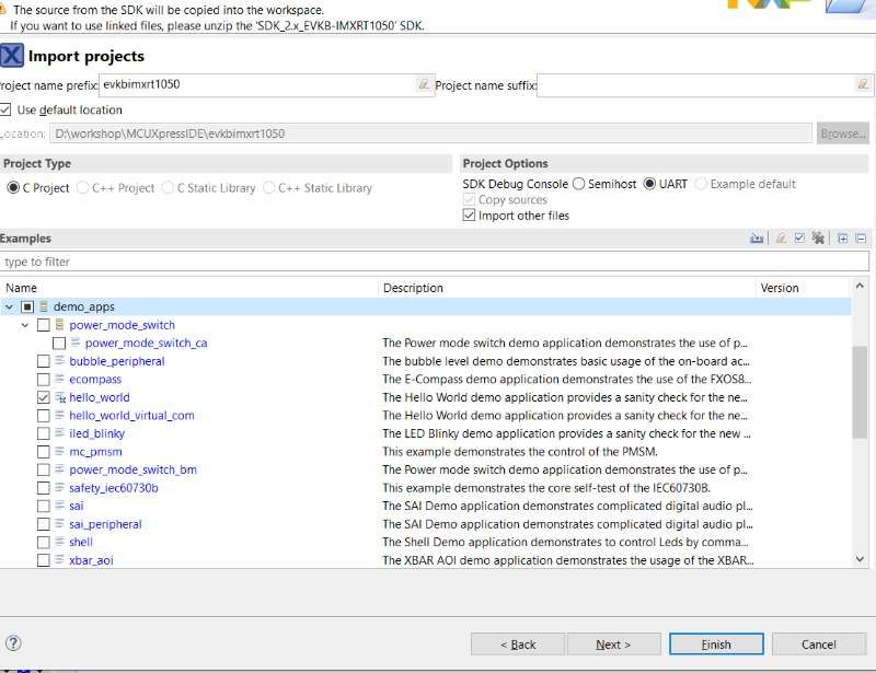

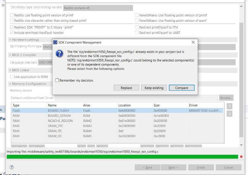

1. in IDE, import   SDK demo apps as below.
xip flash  size and  driver have been  updated   according to development kit manual.
drivers in   SDK xip directory  has been replaced  with conformity with  guide.
2.   After project is imported,  the status screen is as below.

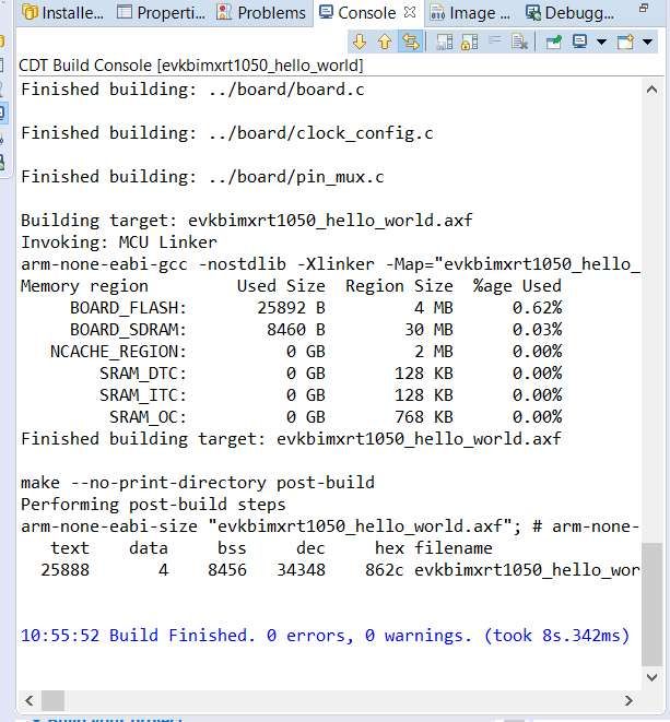

3.  Then build this project, there is no error info. refer to the picture below.

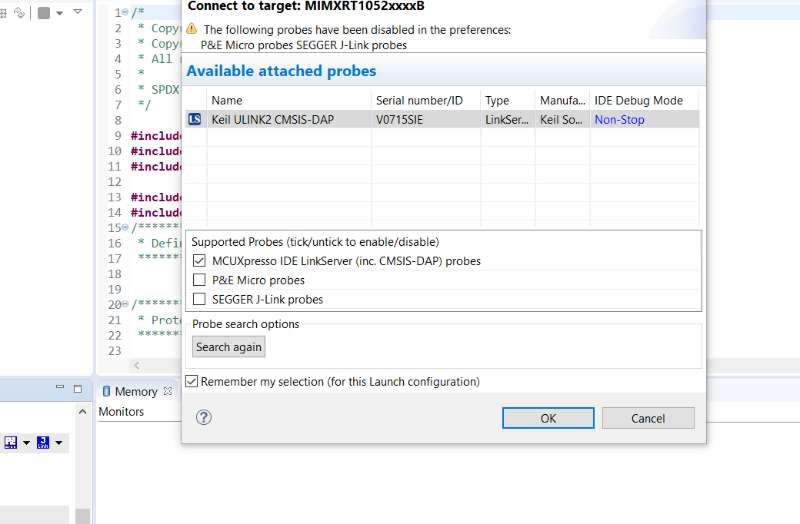

4. Then connect Ulink2  and usb-to-serial to oem board. These devices works well.  Tera  terminal is used to capture serial output.
debug probe is connected  normally and refer to the picture above.

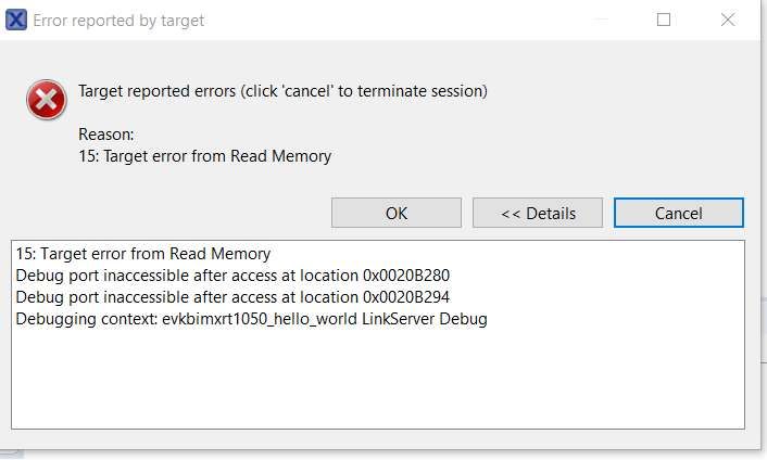

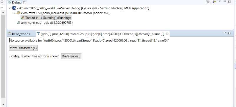

5. Then run debug session about this project.  Then meet the error below.
5.  in the debug window,  there is no  main() function to show either.
BTW, this board can work normally  before debugging this  hello world  project.  After it powers up this board,  there is  log output to   serial console and in the meanwhile,  LCD can work normally and show  some hints.
