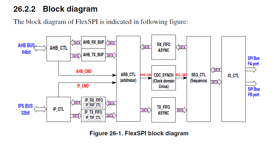

I have already asked a question about FlexSPI here: Can we use a XIP flash and a data flash at the same FlexSPI controller?
The answer there was that using XIP on port A and saving data on port B will not reduce the performance a lot.
The block diagram from RT1020 Reference Manual
looks like port A and port B share the complete FlexSPI logic.
There is only one ARB_CTL block and only one SEQ_CTL block so even if reading is done with AHB bus and writing with IP bus it is only possible to communicate with port A flash or port B flash at a time and not with both at the same time right?
If we now connect the data flash from port B as a second flash on port A we would only need the additional FLEXSPI_A_SS1_B Pin and save pins from port B.
Will connecting both flashes at port A reduce the performance compared to XIP on port A and data on port B?

jeremyzhou
Hi Stefan Mitterhauser,
1) There is only one ARB_CTL block and only one SEQ_CTL block so even if reading is done with AHB bus and writing with IP bus it is only possible to communicate with port A flash or port B flash at a time and not with both at the same time right?
-- Yes.
2) If we now connect the data flash from port B as a second flash on port A we would only need the additional FLEXSPI_A_SS1_B Pin and save pins from port B.
-- No, I'm afraid it's impossible.

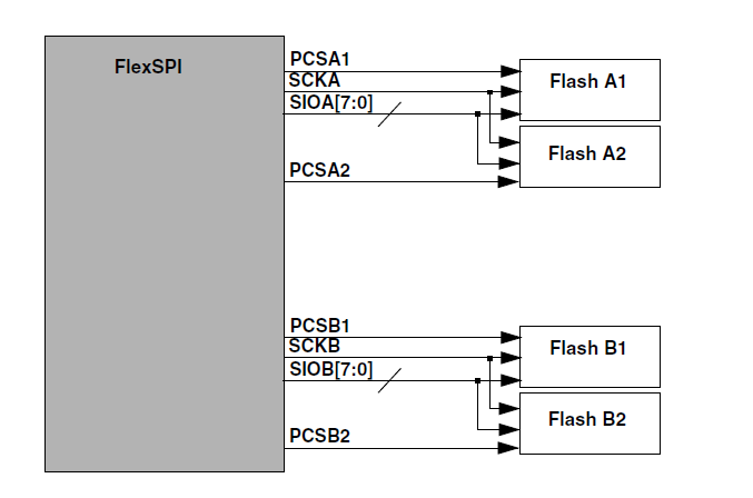

In the reference manual you can find this diagram
which looks like you can connect two flash devices to port A and two to port B.
Why is it not possible to connect two QSPI flashes to port A?
If it is possible: Will connecting both flashes at port A reduce the performance compared to XIP on port A and data on port B?
Kind regards,
Stefan
2,395 Views
jeremyzhou
Hi Stefan,
Thanks for your reply.
The FlexSPI port can connect the two external flash chips when code runs in neither of them.
Hope this is clear.
TIC

imxrtuser
Senior Contributor I
Hi Jeremy,
so you are saying:
  1. Flash A1 for XIP and A2 for data will not work?
  2. Does Flash A1 for XIP and B1 for data work?
  3. Is it possible to XIP from Hyperflash if you use Cypress Hyperflash and additionally Cypress Hyperram on FlexSPI?
Kind regards,
Stefan
2,395 Views
jeremyzhou
Hi Stefan,
1) Flash A1 for XIP and A2 for data will not work?
-- Yes.
2) Does Flash A1 for XIP and B1 for data work?
-- Yes.
3) Is it possible to XIP from Hyperflash if you use Cypress Hyperflash and additionally Cypress Hyperram on FlexSPI?
-- Yes, however they shouldn't connect the same port of the FlexSPI.
TIC

imxrtuser
Hi Jeremy,
The software of Application Note AN12564 shows how to implement 2 QSPI Flash on port A of RT1060 and it seems that it is also working on RT1020 (partly, I think there are some bugs in the example e.g. always waiting for busy flash A1 instead of the programmed flash A2).
Could you please explain why you think that we can not use XIP on A1 and data on A2?
This would mean that you never can use both with RT1020 and RT1050 at the same time because to get the Cypress Hyperflash/ram working on these processors you have to combine port A and port B to Octal Mode -> no separate ports left.
Kind regards,
Stefan
2,395 Views
jeremyzhou
1) Could you please explain why you think that we can not use XIP on A1 and data on A2?
-- After confirming with the AE team, the AN12564 actually provides a way to implement RWM function when connecting Flash A1 and Flash A2 to port A of FlexSPI, and it should due to the DMA transmit function.
However, the AE team recommend to the developer to connect flash A1 and flash B1 to port A and port B respectively to implement the RWW function.
TIC
