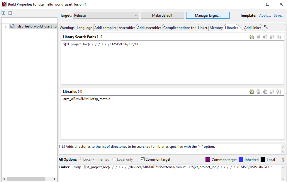

Platform: iMXRT595
SDK: SDK_2_11_1_EVK-MIMXRT595
Xtensa Xplorer IDE version: 8.0.15 Windows
DSP application: Hello world
I am trying to link SDK_2_11_1_EVK-MIMXRT595\CMSIS\DSP\Lib\GCC\libarm_ARMv8MMLldfsp_math.a to a DSP application. For this, in Xplorer IDE, I set the following:
C:/usr/xtensa/XtDevTools/install/tools/RI-2020.5-win32/XtensaTools/bin/xt-ld.exe: cannot find libarm_ARMv8MMLldfsp_math.a
make[1]: *** [dsp_hello_world_usart_fusionf1] Error 2

aravind_t
Hi Edwin,
I was linking the wrong library. My objective is to run FFT on DSP without using PowerQuad.
I learned that this could be done through NatureDSP library and I was able to run naturedsp stock example:
SDK_2_11_1_EVK-MIMXRT595\boards\evkmimxrt595\dsp_examples\naturedsp
Library link issue is not relevant anymore. Thank you for the support.
