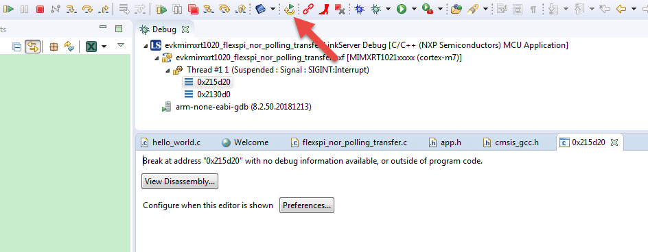

Hi support community,
I tried a  flexspi_nor_polling_transfer project with IMXRT-1020EVK.
The Debug console function works properly when it was under debug (connected with IDE).
However, it doesn't work when downloading a firmware into a Quad SPI flash. (not connected with IDE)
I tried another sample project, e.g, lpspi_interruptb2b_master, the Debug console function works properly in both case.
I also tried a same project with IMXRT-1060EVK, the debug console function works properly in both case.
Please tell me how the Debug console function works properly with IMXRT-1020EVK.

Hi Yoshiyuki Okada,
Thanks for your reply.
After investigating, I find that the issue is caused by erase the sector which is also occupied by the flexspi_nor_polling_transfer itself.
So please change the EXAMPLE_SECTOR just likes below, and give a try again.
#define EXAMPLE_SECTOR 20

yoshiyukiokada
Thanks for your help.
I understood the root cause of this issue, however, my question was why "original source" seems to work properly under debug-mode not but under non-debug mode.
Here, "debug mode" means that the EVK is connected with PC and IDE runs the program.
On the other hand, "Non debug mode" means that the program is flashed into Q-Flash on the EVK and RT1020 was boot from the Q-Flash.
Are there any difference between Non-debug mode and debug mode?
Yoshi

jeremyzhou
Hi Yoshiyuki Okada,
I've done the testing of debugging the lexspi_nor_polling_transfer project with IMXRT-1020EVK, it can run only once and it won't be available when clicking the Restart icon.
According to this phenomenon, we can't say it can work property under debug mode actually.
